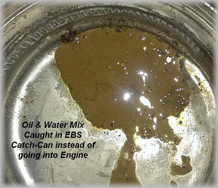

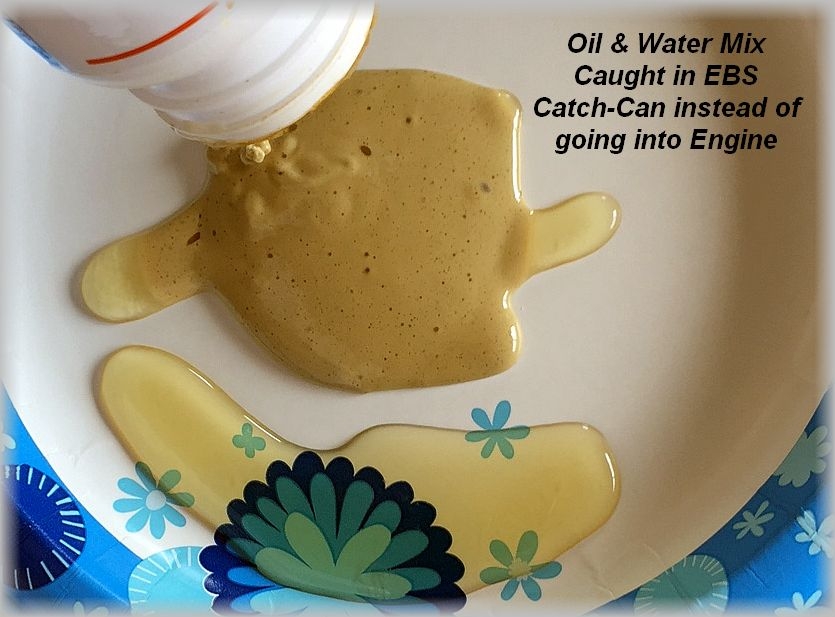

You can do a sneaky pete poor mans catch can. Just disconnect at the tee and route hose into a pill bottle with a hole in the cap for the hose and a 1/8 hole to let air ecscape. Youll be amazed at the snot thats collected.
Here are some photos of what has come out of catch-cans....putting this into the engine is NOT going to burn and produce power...it is going to reduce power. There's a lot more in the video below on why hot, oily, oxygen depleted air reduces power, and produces tune instability.
