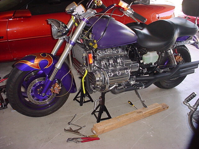

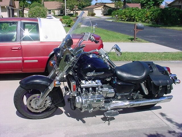

When I got my 99 Valk. Which I bought to do a stock rebuild and use as my trike.
It came with a set of 3 into 3 pipes for each side.
While sound was nice its drone could drive you crazy. I ended up adding some baffles to each pipe. Sound at highway running still droned like mad.
I was told these pipes were worth a bit of $$ and traded them out for a set of NOS OEM pipes.
My current 1800 trike has chambered sticks 2.5 inches one for each side from the cat.
Similar sound but without the drone. Very much like what the original posters sound is.
1st pic is as brought home. Non running.
2nd as finished and then sold.
