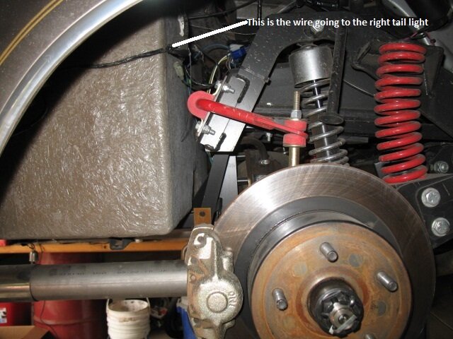

I can't speak for the 2012 and later however the 09 is the same as my 06. I had the same issue with mine and finally fixed it. Take your right wheel off and find the wire that goes down to the right rear tail light. You will find a wire there that will accept the wire from the lower trunk. Once you have the wire in hand it will be easy to plug into the wire harness in the right wheel well.
I can probably find a pic or two if anyone is interested.

Thanks for posting that SMSgt, I am very interested in this, mine doesn't work either. There is a wire in the right wheel well that isn't plugged in to anything, that may be the wire I need. I will have to check it and see if there is any voltage on it. Do you know whether the switch in the trunk needs to be a normally open or normally closed switch. I would suspect it needs to be a normally open switch if the wire in the harness didn't need a shorting link installed to keep the indicator from turning on. That way it would be a closed circuit when the switch is operated. I have looked through the wiring diagrams I have and through the text in the service manuals I have available and there is no mention of the wire, switch or anything else associated with the open box warning. It does include the wiring for the electronic opener though. There is probably a wire for the left side also, I haven't looked on that side.

By what I can see of your pic you don't have a Roadsmith. What you'll need to do is get into the latching mechanism and find the wires that go to the switch. Then the wires will lead you to the plug that should plug into the right taillight harness. I would think that the switch is normally closed because when you open your trunk the switch closes and remains closed until you close your trunk which will open the circuit.
You are correct in thinking that both sides of the motorcycle have the same type there is exactly the same wire setup on the left side taillight but you won't need it unless you are left handed and want to see left bag open instead of right bag open on your dash.
