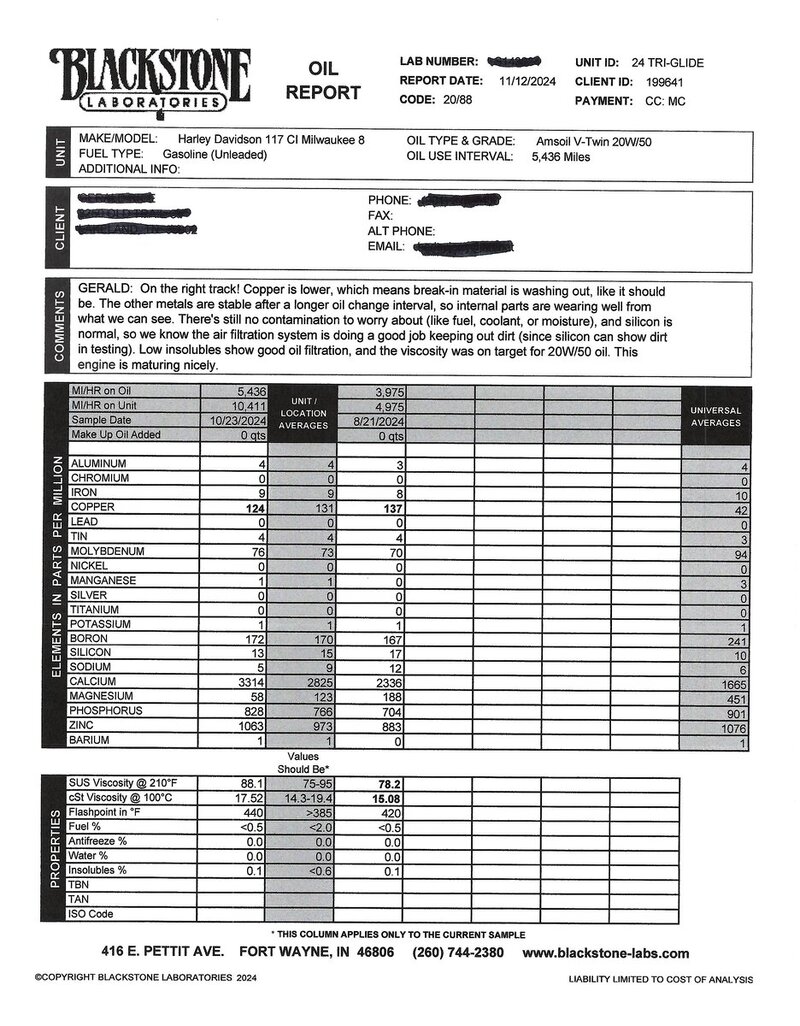

Here on this forum as on many others engine oil is a topic of intense discussion. What brand, what kind - dino or syn, etc. On my initial 1k mile service I changed to Amsoil full synthetic - 20w50 in the engine. Then at the 5k service and again at the 10k service I sent oil samples for evaluation. The results speak for themselves. As you can see the 5k service was in August and the 10k in October - the hottest period of the year. In fact in mid-October in Texas the air temp reached 104 degrees! My oil temp (yes I have oil temp displayed on my Dakota Digital gauges) never exceeded 215 degrees and my trike is bone stock except for a few 'creature comforts' - nothing done to impact performance or engine temps. I do think other brand oils would have performed well also but I am a firm believer in full synthetic in my TG.TG oil analysis.jpg
I'd say, that you got a good lab result..

Hey Jerry,
Good report.
Gotta question for you...on the report it is listed as a 117 CI .
Is that a typo, or do you have something special going on with your TG?
I hope you see that copper PPM down closer to normal range on your next oil change.
I've pulled maybe thousands of oil samples in my 25 yrs of being a offshore mechanic. Wear metal is common with a new engine but it should decrease to normal levels within several oil changes.
The oil drain is not the ideal place to pull a sample from. Using a vacuum pump like they sell with new tubing each sample is recommended. "Same kind of pump I used when a mechanic."
The tubing should be inserted to within and inch or so above the bottom of the crankcase and the sample should be taken quickly as possible after shutting a warmed up engine down. You will have your best true results doing it this way.
I know most people pull the sample from the drain after about half the oil has drained out and that works.
I was just putting in my .02 in about oil sampling.

I would think the copper would come way down next oil change. Thanks for the info about best way to draw a sample.

Thank you for this important information on where & how to collect a oil sample

How do you get a tube into the crankcase of an M8 motor? I don't know of any access to the crankcase from the top.
