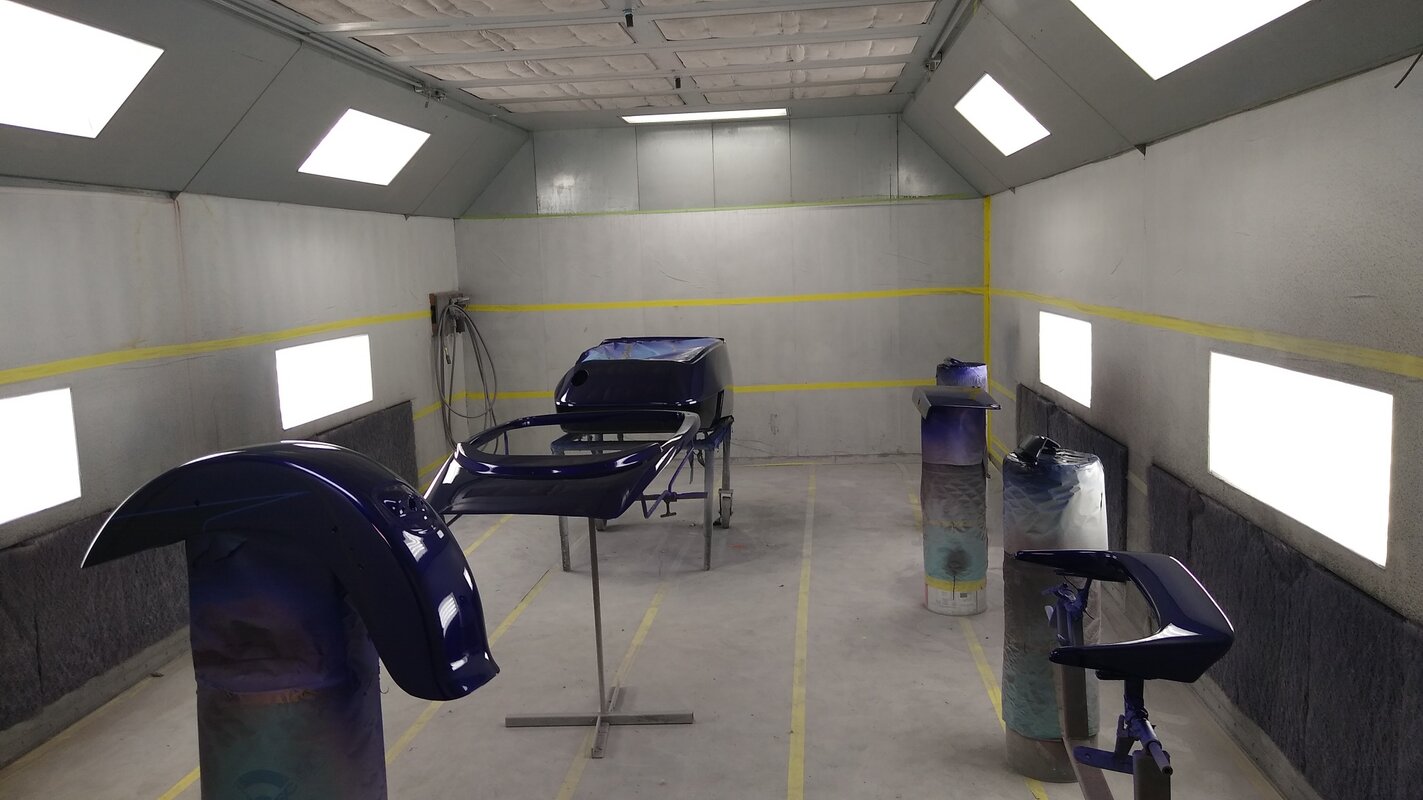

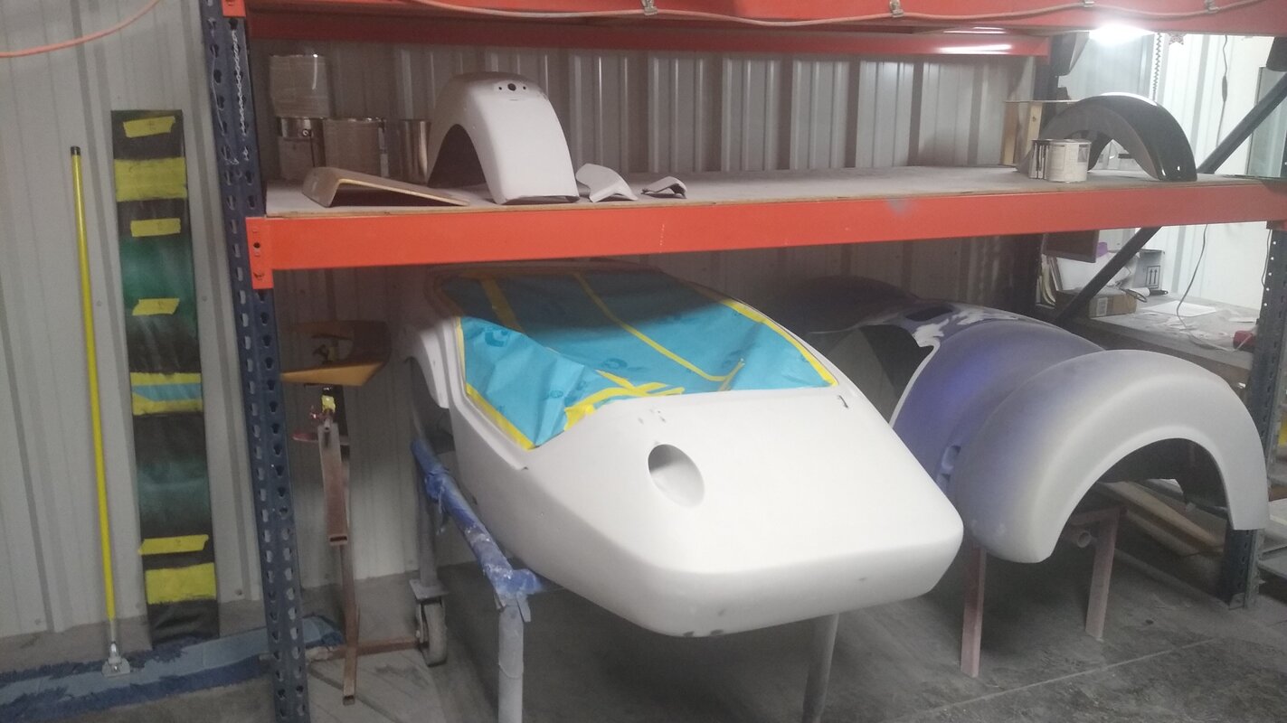

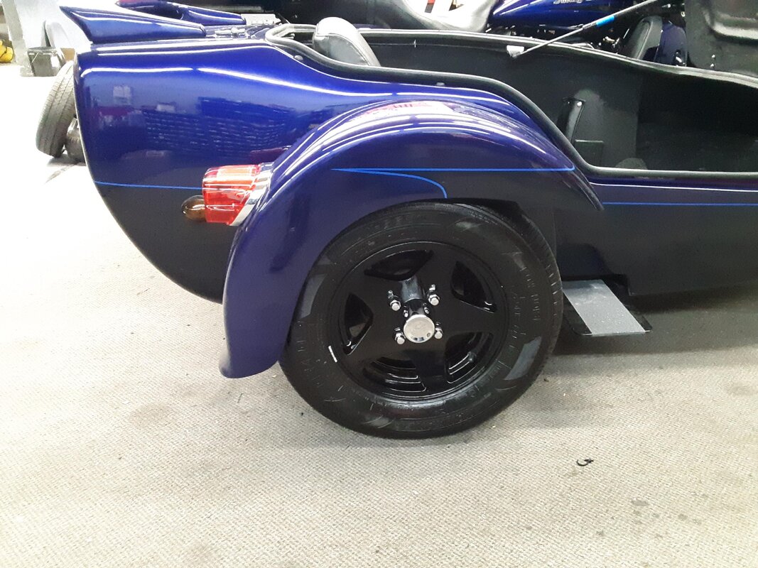

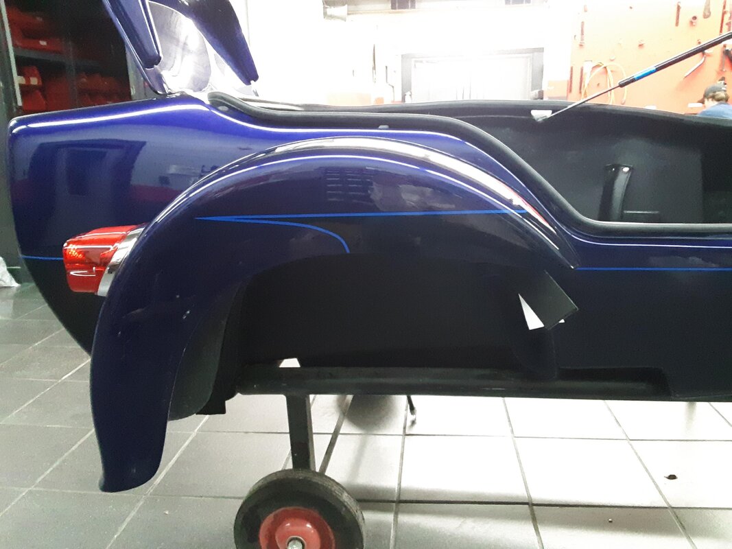

Progress on refurbishing the sidecar. Hannigan called yesterday to verify the VIN number on the bike. Part of matching the zephyr blue,Black Sunglo and the accent striping paint. Painter also ask for more pictures on the graphics on the bike. I am sure he is working on how best to make the sidecar look like it belongs on the bike .
I did not bother with question. The painter is a pro, I will let him do his thing. He did a great job the last time.

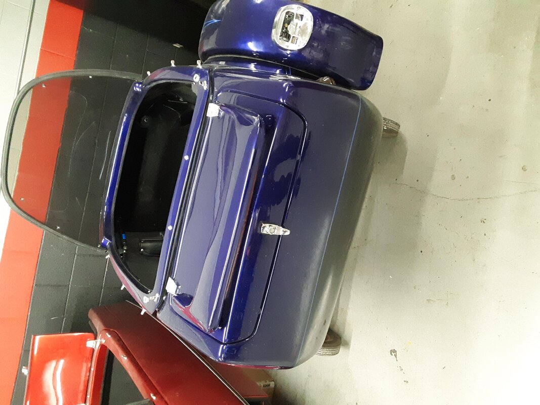

The reverse is installed. Put my bags back on and it is ready for the ride to Hannigan the 14th. No I did not park it like that the site does strange things with pictures.

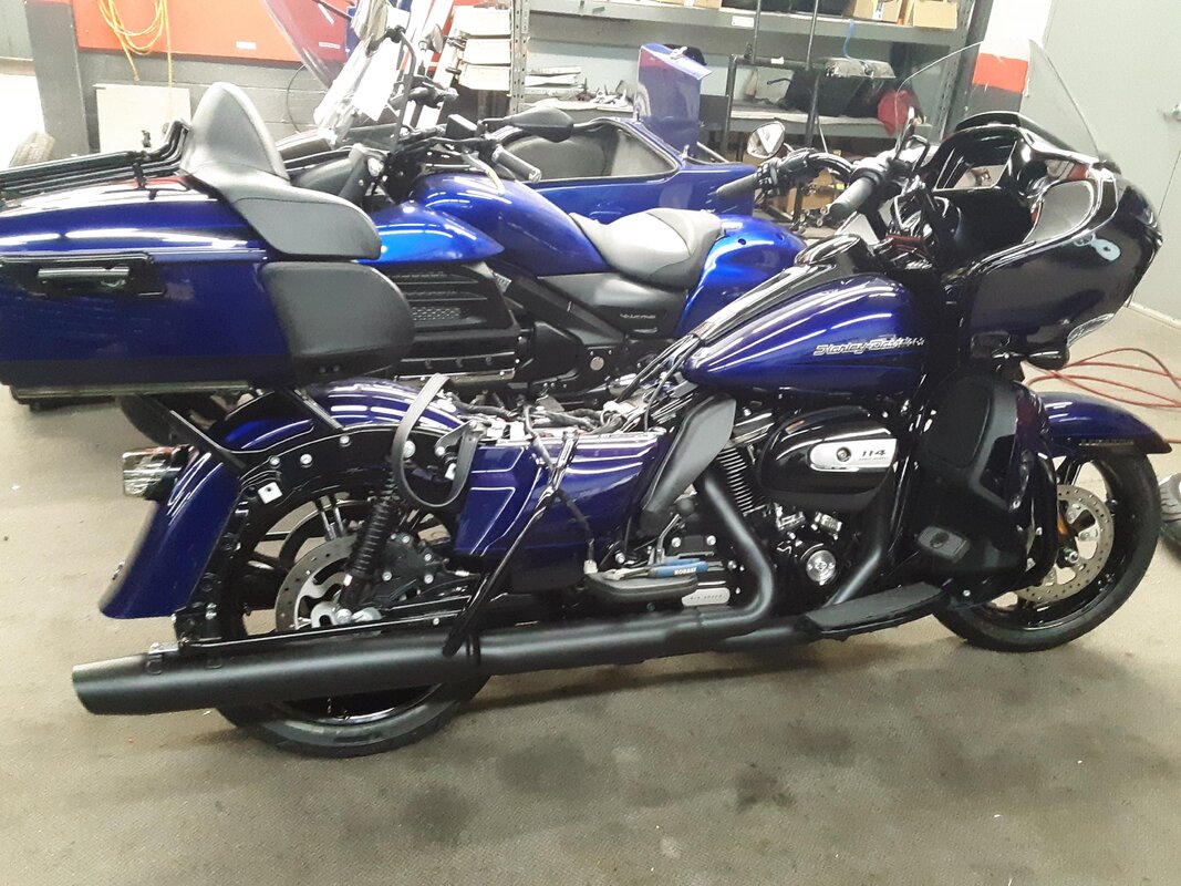

It should be clear to most . I take riding serious. Be it sidecars or two wheels. The sidecars are a special passion because of the world they open up for Payton. The Gold one was not her first. Totaling the Gold 2017 was a sad day. Everyone in this family and many out side it enjoyed that Rig. Sitting here now going over details of the new Rig. questioning any last minute changes , have I made the right call on things. Any details left out. Time is near 3 calls this week form Hannigan I know it it almost time. I had setup time to have the Gold one cleaned up , painted ect before the crash. Hannigan was able to work getting the new Rig done between other work. We have only had a 1 week delay.
The color and mating of the bike and sidecar fit well with the Gold one. I think the New Nighfury dragon will top that. Even when you know what your are getting into it is a journey .
Because the bike is a 2020 the New systems they put on them make mounting a sidecar a bigger project. many things to work around. We shall over come. 8 days out the drive way to Hannigan.
Old
New

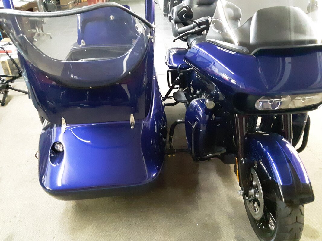

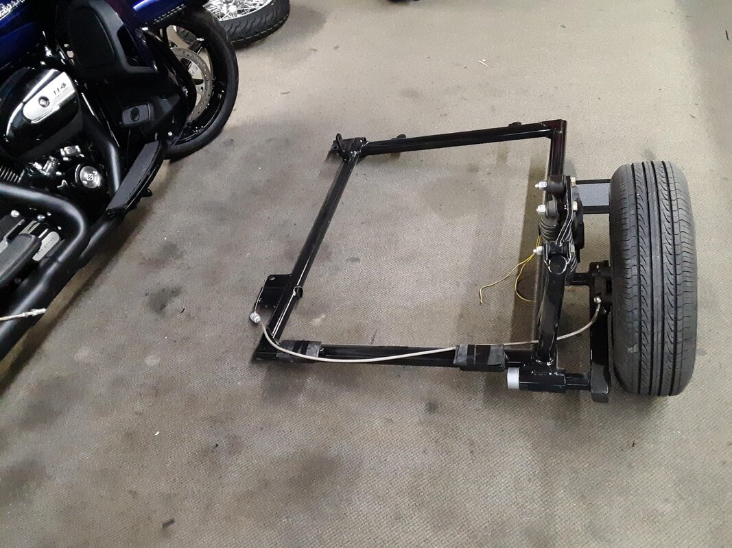

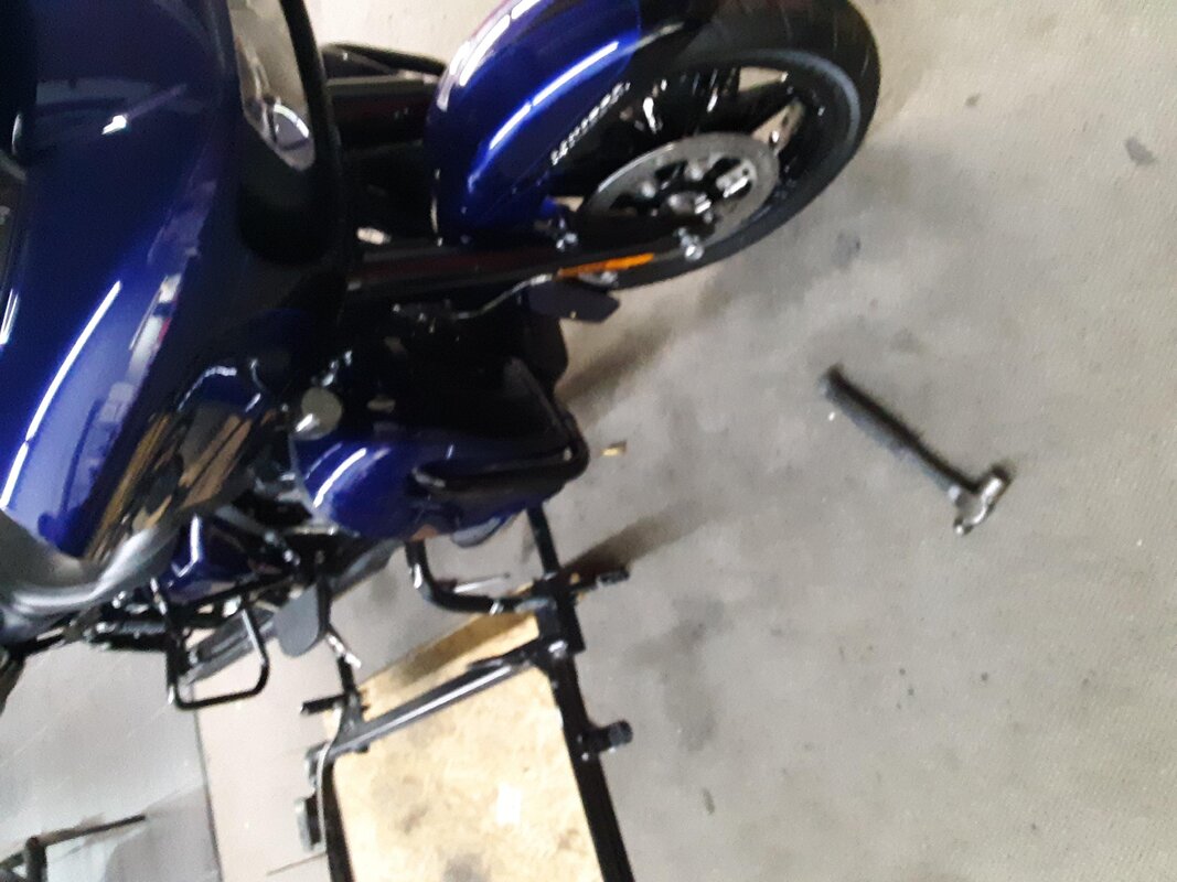

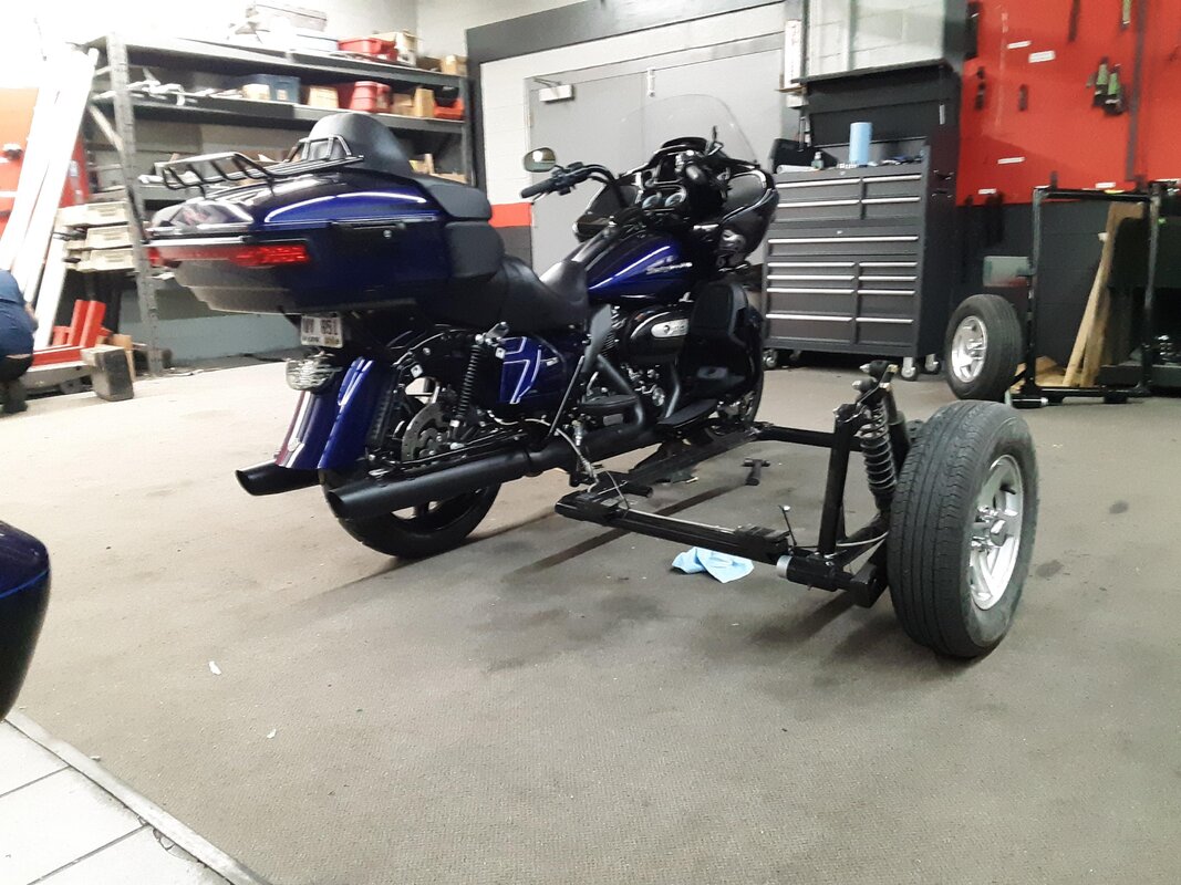

Today frame and bike were joined. The front upper mounts was improved and the upper rear got a little rework. Brake line was cut in ready for the quick connect.
Looks like tomorrow we get it on the road.

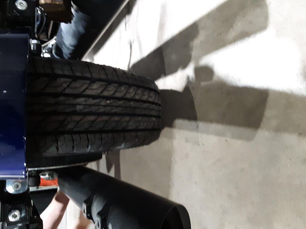

I want to use a Fuel Moto 2-1-2 Jack pot header but need to make sure it will clear the Reverse cover
