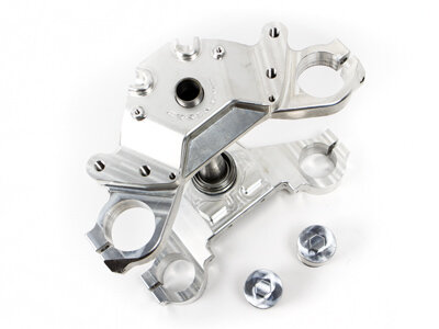

With the shoulder surgery I have decided a little light steering effort would be a good idea..
So Ask Hannigan to go ahead and CNC the steer light tree for me 6% rake.
Edit: Seems the person that knows most about the raked tree is sure 4 1/2 degrees would better suit my needs.
Stronger than some cheaper copper type raked tree.
After doctors appointment on 16Th should have an idea when I setup an install date.trees-top1.jpg
After doctors appointment on 16Th should have an idea when I setup an install date.View attachment 108287
Interested in how the new trees work out. Are you changing the tube length?

Appointment setup to install the 4 1/2 degree tree August 30th at Hannigan.
with i had seen this earlier
i would definitely suggest the six degree
but then i like VERY easy steering.
i had a 88 flh with 6 deg wish i had more, granted the geometry is different so sorta comparing apples to oranges most said 4.5 or 5 would be good but i got 6 on my road star seriously thinking about building a LL 6 isnt doing for me. i did adapt fl adjustable tree on my v max, set up for about 6 an that works great
hope u like your results
6 degree with the tube 1 3/4 inch long to keep height the same on my 2017 it worked well.
The 2020 with 18 inch wheels is not bad with no rake.

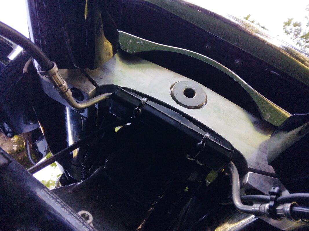

The rake is done. Training it down turn out to be a good choice. Got to Murray KY checked in and was at Hannigan 0800.
By 0830 it was in the shop. they had an equipment break down it the shop that held things up a little. By 4PM I was loaded up and heading home. Arrive at 0200.
Specs. Factory rake is 26 degrees Now it is 30 1/2.
Factory wheel base 64 inches now it is 67 1/2..
As I had said before it was not bad. But slow seed or at a stop it was harder to turn. Now it is like power steering.
