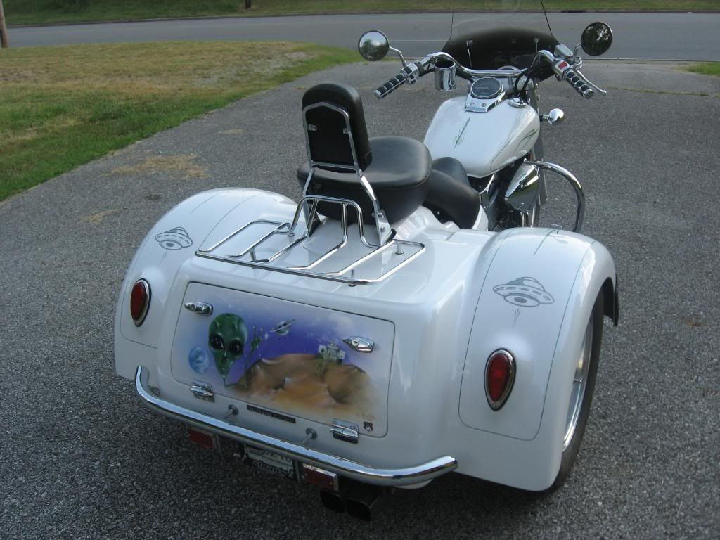

Two holes through the body....It can be done but its a real PITA to do after paint and install! Ask me how I know.
These "slots" were definetly done before paint on my Wife's Aero...I'd be happy to get You some better "Close Up Pics" dxerebl if You want some.....
This Trike has a Honda Bar and Back Pad....I can only imagine the problem of locating the right place to cut after full assembly and paint...GOOD LUCK...:):cool:

Go to the Lehman site, Suzuki Tramp/Jackal, Suzuki accessories, third item down. It's a backrest/luggage rack combo in the picture but they are actually two seperate items. You should be able to get the backrest seperately through a Lehman dealer. The backrest has two brakets that mount with four bolts, two for each bracket, through four holes drilled in the top of the box. That's what I have on my Jackal.

No real easy way. To do it right the body has to come off. I have a lay-on-and-mark-it fiberglass template just for this problem, for the vtx1300s but not for the 750s. Sorry!
Over the weekend, I'll try to take some close-up Pics with maybe some measure points, dimensions in the Pics...I'll repeat, also, Mitzie's Aero has a Genuine Honda Bar and mounting kit. There will be some slight differences in Cobras, etc. ........Let me know, be happy to do it......:wtg:

Not a dumb question at all. Its pretty straight forward. Unbolt the seat, pull the rear lights out and cut the wires (MotorTrike Isnt plug and play on the 750s) and unbolt the body. Thats the easy part. Next you will have to measure, mark and cut the slots at the proper place in the body. You should tape off the area of the body being cut with blue masking tape before marking the slots. After the slots are marked, drill a starter hole and cut the slots out with a fine blade jig saw(tape still in place to prevent the paint from chipping), sand the inside edges of the slots, mount the frame rail mounting brackets and reinstall the body. Mount your sissy bar and youre done.
Be aware of the number of shims (large washers between the body and lower frame) and location when you unbolt the body, as you will need put them back where they came from to achieve proper body alignment. If you have any questions call me at 334-648-0157.
