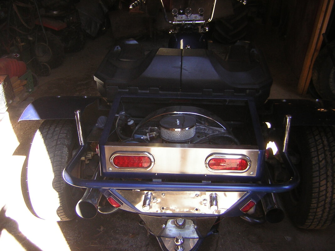

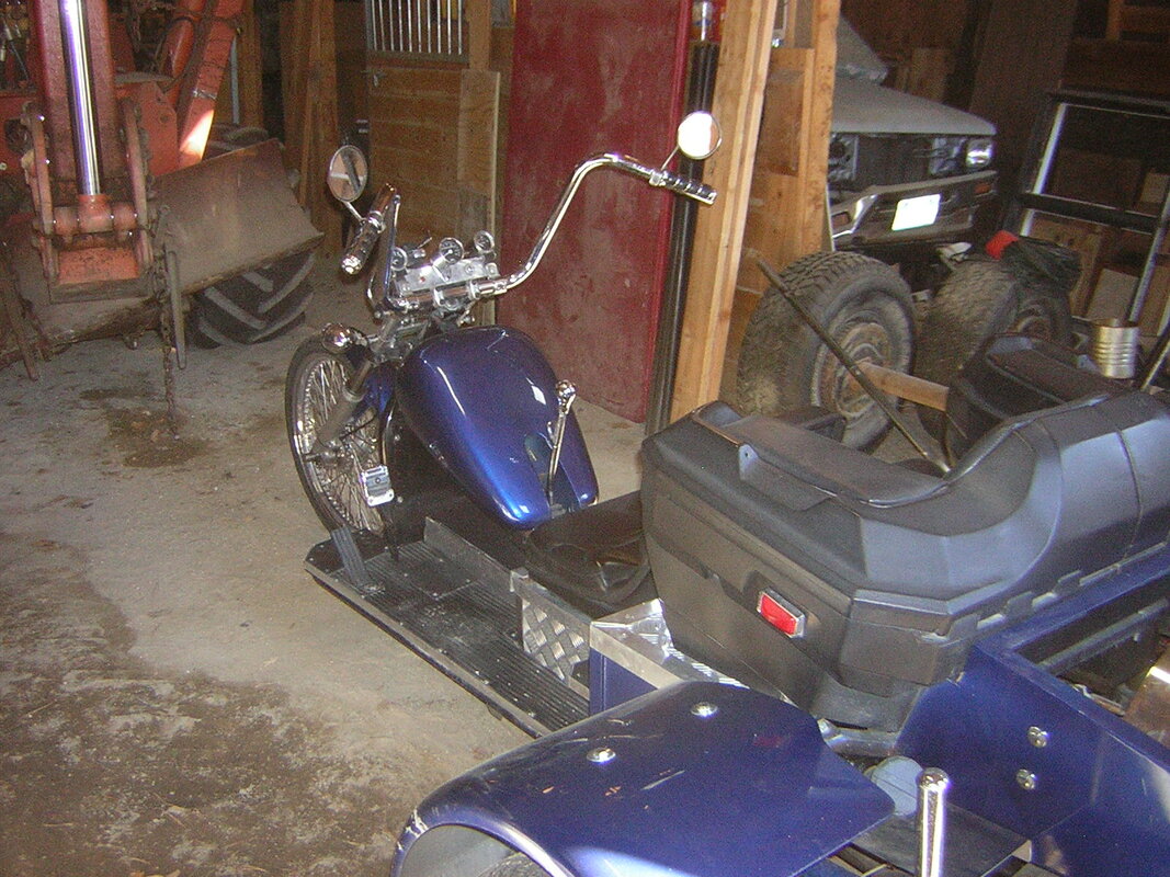

Hi--I purchased this trike sight unseen and have some issues to address.
Every time I take my foot off the brake on the floorboard to push on the gas I roll back. I live in the mountains where everything is hilly. I believe my front end is an Honda 1200. Is there a different front end I could buy or does anyone have ideas what to do for a brake??? 2nd. problem is the steering is really heavy to the right and the left. Is this normal or is it how this trike was built? What I mean by heavy is that when I steer all the way to the left or right, it is difficult bringing the steering back to driving straight. Any idea why this would be. Just need some help with things I wish were a little different.
Thanks much.

Addressing your issues individually,
1. As to needing a brake while you take off on a hill, the easiest method would be just what you mentioned. Find a caliper and brake disk to fit the front end (from salvage or ebay, etc.) and install in a stock setup. As to the front end, you have a VIN plate on the neck there which should give you a headstart to the manufacturer. A second possible solution might be to add a VW emergency brake handle and cabling mounted just to the left of the gas tank (on the floor is OK). That way, use your left hand to hold it steady while disengaging the clutch. A third easiest but perhaps the most awkward method would be to add a line-lock in the brake line within easy reach. That offers a large push-pull button to lock the brakes and hold them as long as it is engaged. Press the brake, pull the line-lock (or as a brand name 'line-lok') to lock, get your gas and clutch working and press the line-lock to release. That will take a little getting used to for a smooth takeoff, but it should work.
2.
The heavy forks you are experiencing are a product of simple geometrics. Addressing as trail, your trail factor with the raked neck you have will significantly be on the high range (ideal being 3-4" by most trike techs). The only solution to get easy steering is to either add a set of raked triple trees or redesign the front end to move the axle forward without changing any other key elements (i.e., going to a springer or a leading link type front end). Most cost effective (unless you are a good fabricator) will be to find you a 4.5 to 6 degree raked trees set off Ebay. You can find them as low as <$200 if you shop and are patient. You'll also have to keep in mind your particular brand of front end to see how readily available those raked triple trees are. Installation is a relatively easy do-it-yourself job. As an educated guess, 4.5 degree raked trees would give you a reasonable compromise for all around handling, while 6 degree trees would give you steering virtually effortless throughout its range but the front end may tend to feel a bit light at highway speeds (but you will get used to it - 6 degree is what I always go with).

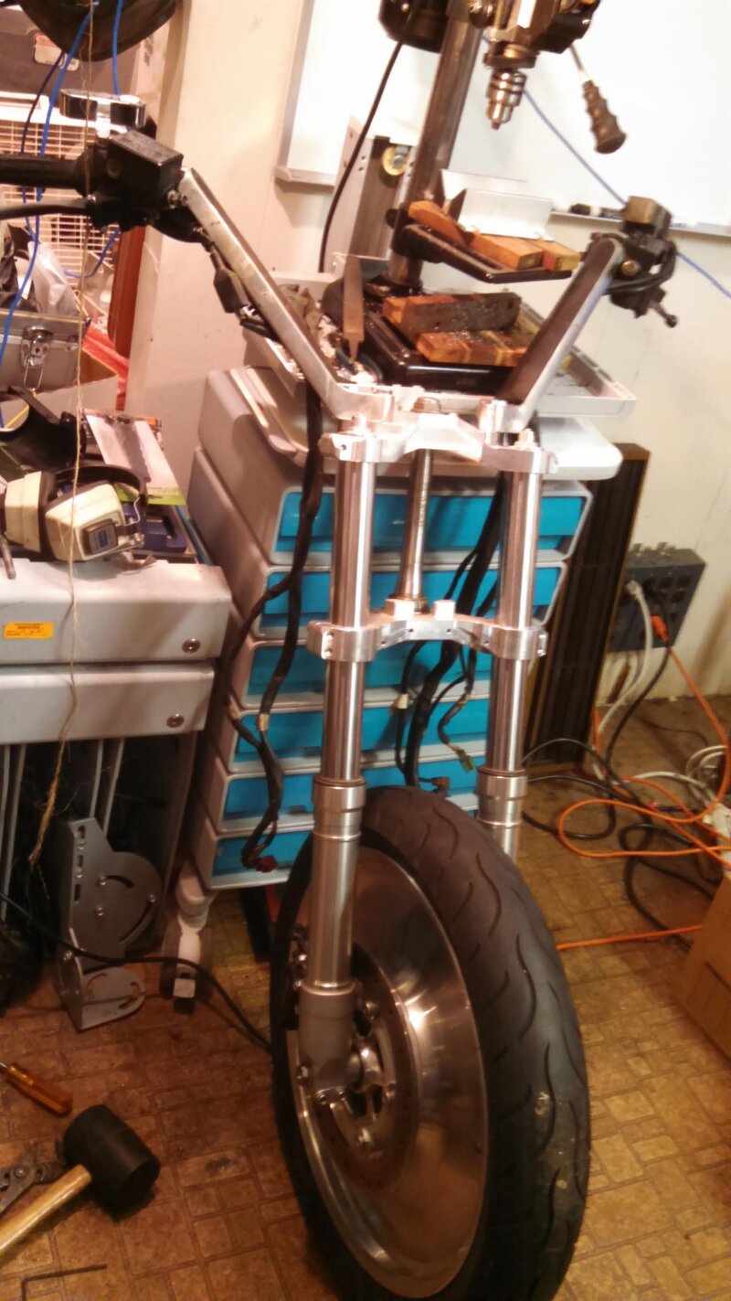

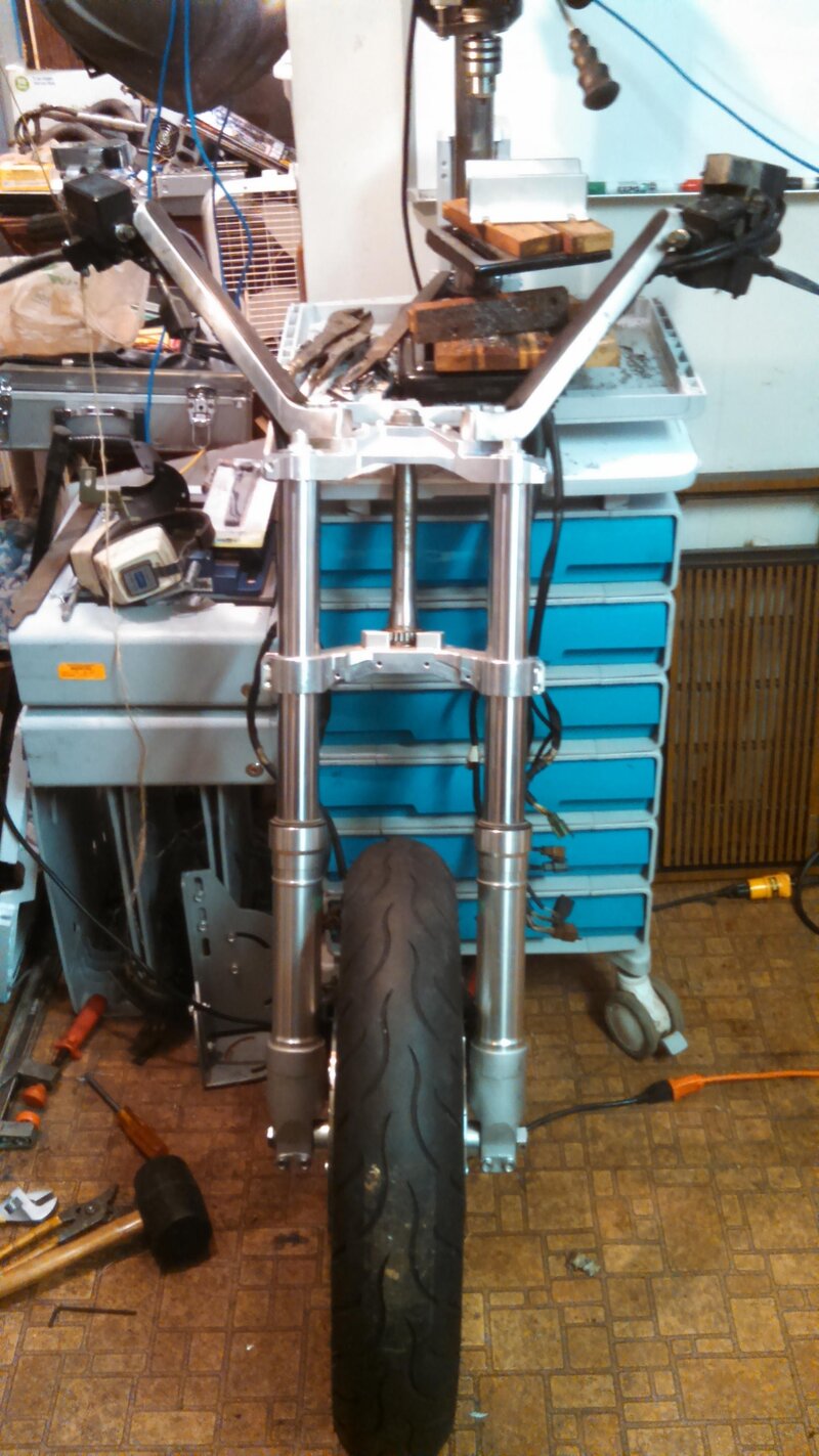

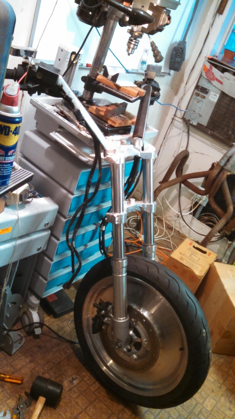

I have the front from my 85 wing.
I am changing to a springer styled leading link and a kasawaki front wheel.
The wing front wheel is a 16 inch diameter.
View attachment 25989View attachment 25990View attachment 25991View attachment 25992View attachment 25993View attachment 25994View attachment 25995

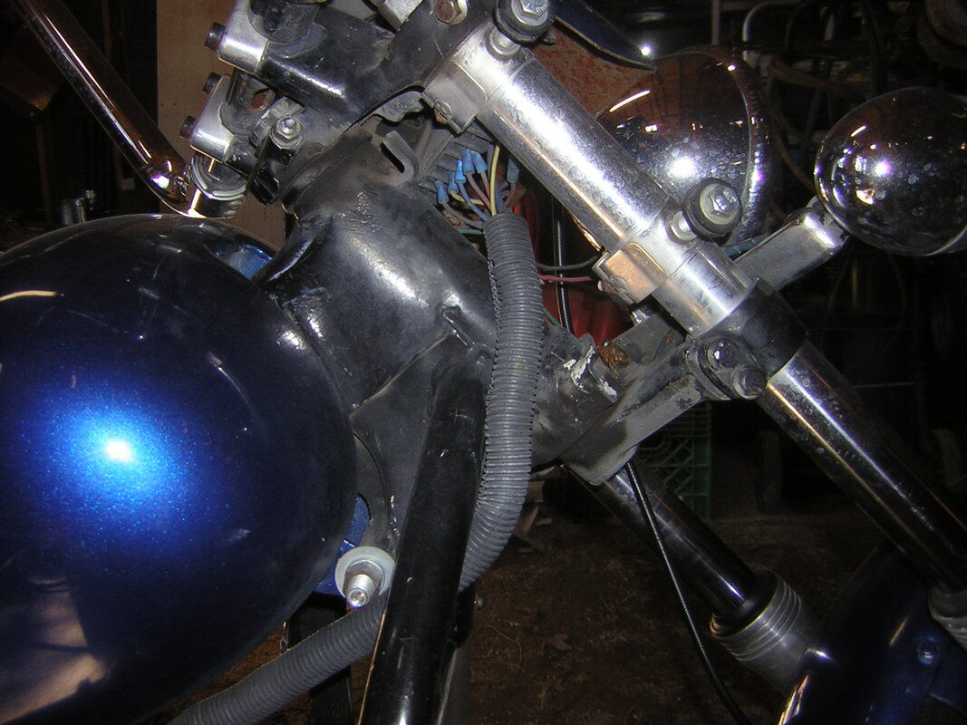

It's difficult to tell from the pictures but it appears your axle may positioned on the back side of the sliders.

I am gonna try to help. Don't get mad at me, I can be a bit blunt.
Stiff steering.
A wing has LOTS of trail to begin with. Made for straight highways and speeds to match.
It has been "raked". Tilted farther out. This makes even more trail. The rim/tire has been changed from 16 to 21 inch. This increases trail even more.
So you have huge amounts of trail. This makes it stiff to steer. Lucky for you that you have a rear engine and light front so it is rideable. Engineering error in frame design.
Live with it or change the front end.
