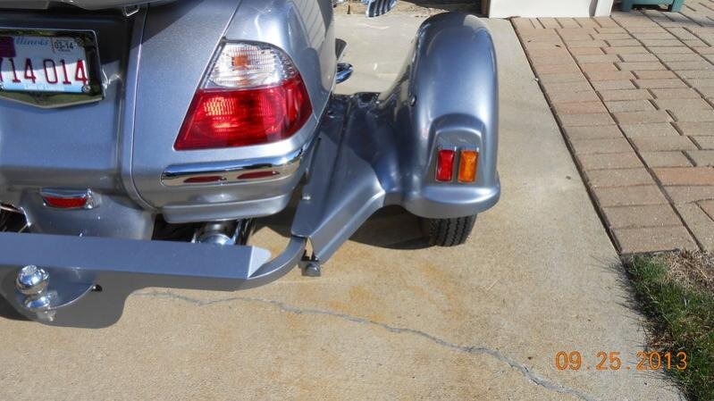

No DanB i never have had any problems with any of the bolts breaking or loosening. the kit has been on the bike since shortly after New in 2006. Now to change the tire the easiest way is just remove the fender (easy job) . And No vibrations at any speed , i keep 50 psi in the tires and no problems. You will get some fender rattle on rough roads, Tow Pac recommends puting a piece of felt where the mounting bolts go , but i haven't. heres a pic of the back of mine , just don't look at the dirt.

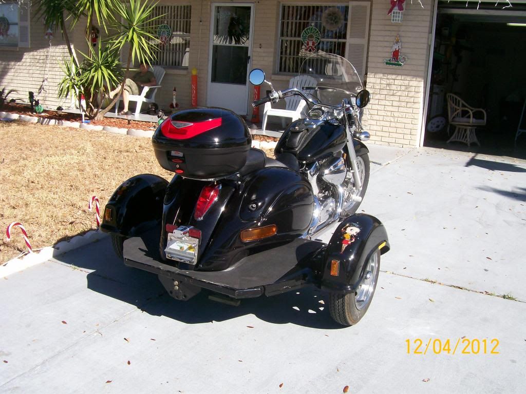

CBLACK>>>>>>wow, thats great looking Tow Pac you got there! May I ask what you have where the fenders are bolted? is that a metal pad you have there? or something else? I like how it hides that area. great job!
DanB i just used a small floor jack under the torsion part of the axle and just lifted the one wheel off the ground.
LouLou2 that little cover is a piece of plastic that is hard and the exhaust doesn't melt it. i am not sure what its made of because the previous owner put it on, i like it because it covers a lot of ugly and when its cleaned with armour all it looks great.
CBLACK>> How is the mat attached to the kit? My husband has stuff like that at work. Think I'm gonna try that myself. Hope ya don't mind me copying you! Thanks for quick response! LOU
well believe it or not they used liquid nails to glue a 1/4 piece of wood to the tow pac frame (just to raise the height and make it flat) and then glued the plastic down to the wood strips with liquid nails, works great even a 70 mph it stays there.

Your rig looks great Dan and I also find that I really enjoy mine on my 1800... I just rode mine 650 miles from my home in Illinois to my new home in Tennessee... I had the bolt on the left lean stop break loose and I had to readjust it when I got to my destination in Tennessee but that was no big thing... I am learning the dynamic of all the adjustments on the trike kit, but have not had a lot of time to play with it since we are in the middle of selling the Illinois house and getting moved in at the Tennessee house... I will report back when and if I have any bits of learned knowledge to report on...
In the mean time, I am enjoying the ride with the trike kit on... I still do rode my bike on 2 wheels as well but the Tow Pac Insta Trike is doing everything I want it to at a considerably less cost than a full trike conversion...

Quesiton: what kind of hard saddlebags are those? I really like the look of your Two Pac with the cover panel and the choice of hardbags...blends well
