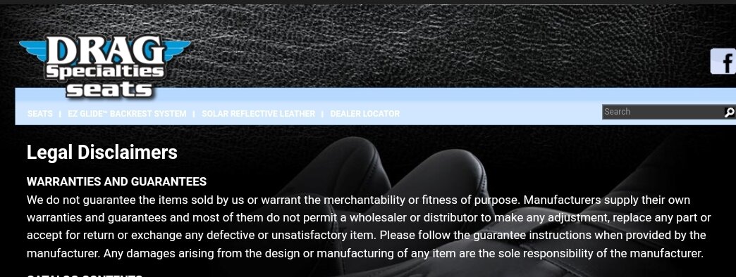

I did see where Drag Specialties does not offer any kind of warranty or exchange and that the manufacturer is responsible for the warranty.
The odd part is they are listed as an actual Drag Specialties part. You may need to contact them to find out who actually makes those rotors. Sorry I couldn't be of more help.
