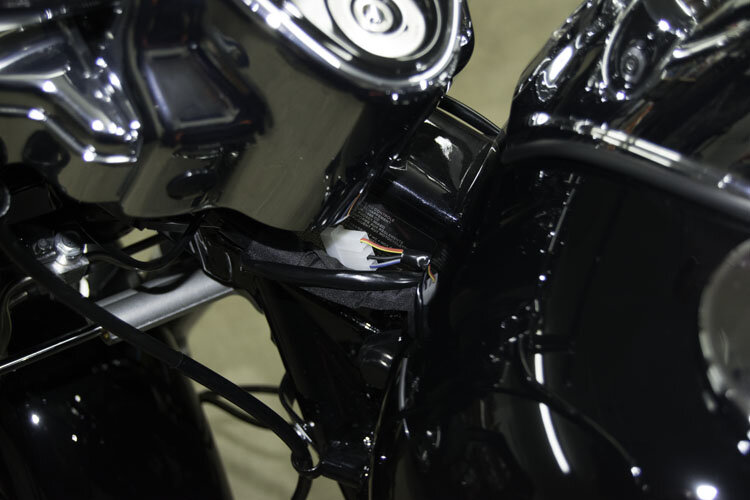

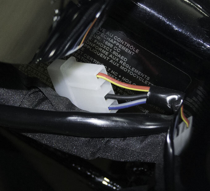

Could somebody tell me what this plug is for. I come across it while going over the wifes new Freewheeler. It is along the left side of the frame just in front of the tank and just before the neck. Seems to me it should be capped off to keep dirt and what not out of it. It must be for future accessory or something. Have a look at the pics and see if anyone knows what it's for.
It's a white Molex 4-pin female connection with 3 wires out, doubled-back and secured with a nylon cable strap. If you have a 2015 Trike Service Manual Supplement (P/N 99601-15) Appendix 'A' Wiring, A.2 Wiring Diagrams, turn to Page Figure A-8, Auxiliary Lamp Switch.[109A] Cut the nylon cable strap to release the Molex 4-wire connector you'll use to connect it to the auxiliary lights.
The Molex 4-wire connector is well-known in the computer industry, to connect old-style (parallel) hard drives. You can buy a pre-wired male Molex connector in any computer store.
