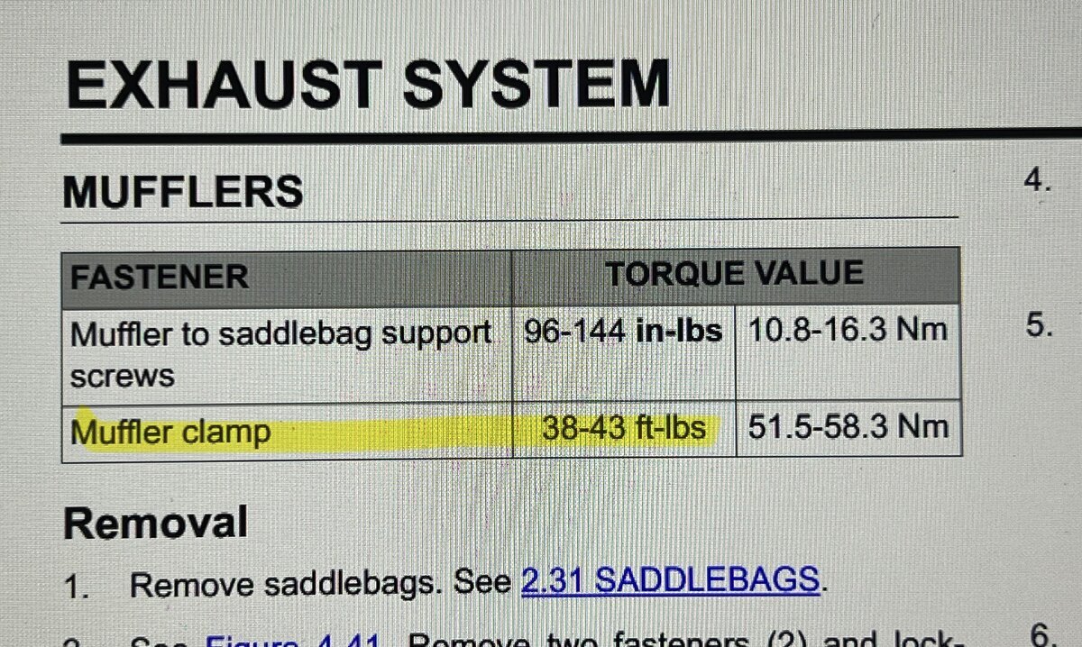

But out of my 2014 Tri Glide service manual, the slip on muffler clamp torque specs is: 38-43 ft-lbs.
(These specs are the same as the touring bikes, and not shown in the actual “trike supplement).
Pic:
