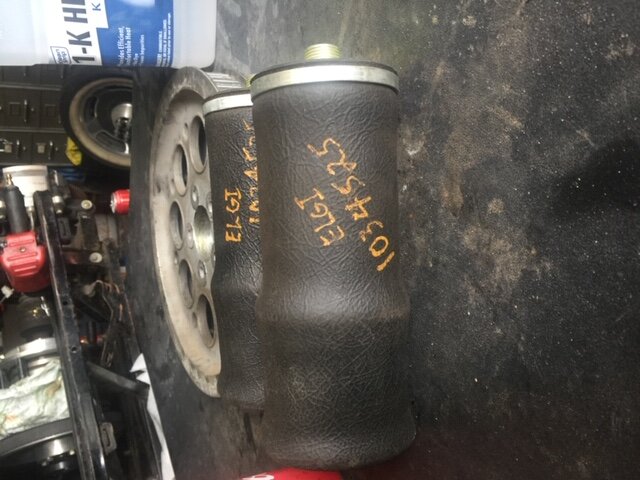

Ordered the Air Springs this morning from Airbagit in AZ (Same bags as the above link - only half the price)
http://www.airbagit.com/v/vspfiles/pages/AirBags_PAGE.htm
The bags I installed in our 2006 GW1800 Motortrike are the same as you ordered. They solved the problems and worked great. I would also suggest you change out the air lines and fittings to commercial grade instead of the cheap Mickey Mouse fittings Motortrike used at the factory. Most automotive suppliers sell air lines and fittings.

What part number shock and spring did you use. We are also having air bag issues. Have already replaced air bags once. Same problem with another leak. Thinking there is another problem
I replaced my 2007 gl1800 motor trike Spyder 2+2 (solid axle) bags myself and it took about 2 hrs. purchased them from motor trike dealer in Wyoming. great service. Still leak proof after 3 years. You can do it.
Air bags were replaced less than a year ago. Evidently dealer didn't fix the issue causing the issue. They will be getting a call Monday. Thinking different shocks could be a remedy.
