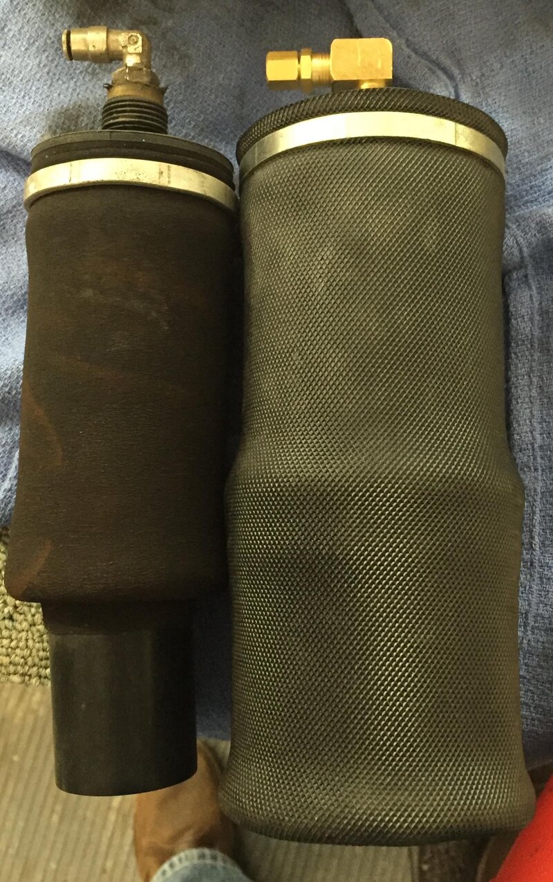

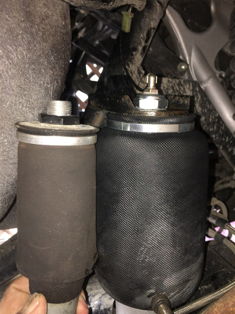

A word of caution. I just replaced the air bags on an '03 MT solid axle conversion. Trike now rides better than new! The new air bags are much larger diameter so several guys have had tire rubbing on bags issues. One person destroyed the bags.
The trike I worked on recently had the rear tires replaced with a narrower size or I think there would have been a rubbing issue here. Something for you to ponder... :xszpv::xszpv:
Here is a photo of the two different air bags and one of the new bag installed showing space to tire.

I know this is an older thread but still relevant to those looking for information about air bags on Motor Trikes. Thanks to this tread and some of those posting on it I now have new improved air bags on my trike. Total cost 90 dollars. I picked up the new air bags from a forum member who had a new spare seat. In changing the air bags out I soon discovered the air line fittings on the OEM bags are cheaply made and not very well made.
I decided to replace the fittings with new NPT 1/8 brass fittings. As you can see in the photograph the new air bags are substantially larger with metal tops and bottoms. The new air bags are industrial grade with greatly improved quality over the OEM bags. Even though the new bags are larger I haven't had a problem with the tire rubbing the air bags. While it took me some time to swap the bags I could do the next set in an hour or less. My Motor Trike is a Spyder body made 4/2007.
Handing and ride seems much improved, i'll add a ride report once I get a good ride in hopefully tomorrow.
