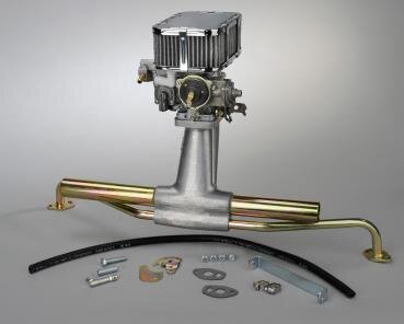

Also wondering what that vacuum hose in the picture posted by vw driver was used for?
If that was to be used as a crossover, I'd say forget it and get a length of metal tube with an I.D.
between 6 and 12 mm then cut to fit.
