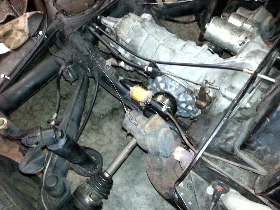

Hello, He checked every thing suggested. It turned out to be a broken tranny mount. He found it looking for some thing else. He said he fixed the mount and the scooter runs as it should. Thanks for all the help and your time.
ThumbUp..............
A tranny mount, that is crazy, but one to add to the book of things to check. I am glad to hear you have it all working now.

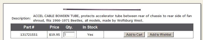

I am going to do a little clarification on this.
Typically "surging" means up...down...up...down.
A bad or missing bowden tube.
Usually make more of a single surge. As you release the clutch and the engine torque pulls away from the cable it open the throttle and as the acceleration setts and the engine torques back down the closes the throttle.
So this feels more like a zoomy start off.
I suppose that if you had an extremely bad engine/trans mount and it was all flopping about while driving it could feel like a surging engine problem.
So when you are trying to diagnose.... See if it is a zoomy start off or an engine surge at cruise.
By the way.....clutch chatter is usually bad or missing bowden tube or bad motor/trans mounts.
And also the throttle is usually a non issue on a trike as we typically use motorcycle cables and they do the same thing as a bowden tube.

Thank you, man. I was starting to go nuts wondering why my trike seemed to want to launch just after shifting, every gear, lol. Thus far, Ive been leery of even trying fourth gear out.
I think you just nailed my problem, I'll check it out in the AM
