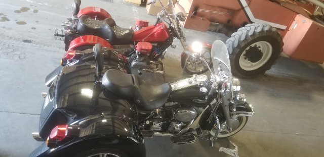

Speaking of Harley and Trikes.....here is my mid compared to a Harley.
A touch shorter even with the "raked out springer".
And a lower overall (other than the apes), seat is very much lower
Also, it is quite a bit narrower (track width).
And,......yes some mid buggy parts involved.
And again .......mine is a bit more modified than "usual"
