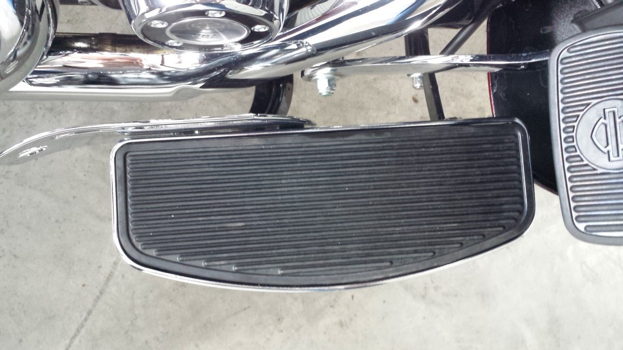

I've done the same as many folks here, floorboard extensions and the heel protector.
