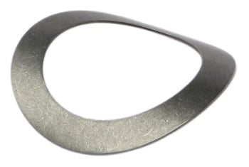

the shifter levers I have removed and put a wave washer on the shaft before putting the shifter arms back on, Why? Good question, grab your shifter see how much it wiggles? The wave washer will take out most of the slop { years ago on older baggers we would cut an old valve spring down instead to put more tension on, BUT it was hit and miss}
Pingel makes a shifter shaft with a grease fitting in the end so no drilling is needed
{ u can drill and tap the rear brake pedal also} I did both shafts on the trike, if u r careful and drill slow and use a blow gun and pump a lot of grease thru when u r done, there is NO need to remove any parts JMO with 13k miles and NO ill affects on my 17 M8 FREEWHEELER
The wave washers can be had at any Lowes or Home Depot look below
