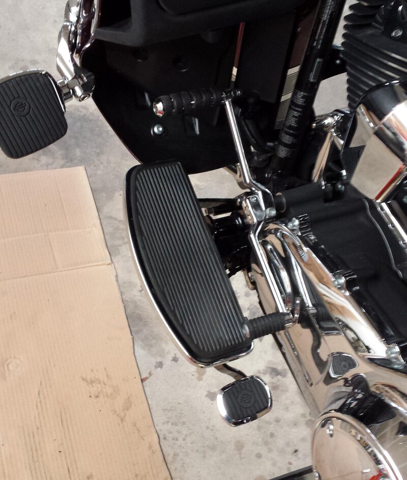

My extended lever came in this morning. I put it on and lowered it a notch. Rode it a little and with a little time, I'm sure I will like the extra room. Only thing is the one I ordered has poor quality chrome. I can see what looks like copper through some imperfections. Oh, the pinch bolt was smaller than stock, not as beefy.
ETA: I still want that longer peg for the toe shift lever like Bill G shows in post #5.
21-1665 Cats paw extended shift peg is what I have.
For those thinking about the extended lever. If your trike has the parking brake pedal by the floor board, with the 8.5 inch lever, the peg ends up directly above the pedal. If you set the lever too low it kinda gets in the way of getting to the pedal.
I was thinking, if I wanted to get rid of the heel shift, I think I would just take the peg off and leave the lever there to keep my boot off the primary. (Oh, this was said in post #41.)
Who says you can't teach an old dog ... after reading more posts I decided to re-install the heel shifter lever. I've removed it on my other 2-wheel Harleys (4) over the years and never had an issue with finding neutral. When the engine isn't up to normal temp., a soft tap of the heel shifter finds neutral like magic! When the engine is hot, as in it's 105 degrees in Las Vegas and I'm riding in stop and go traffic, the heel shifter isn't much good - yet. I ordered and extended heel lever and will try it again. (The stock levers don't leave enough room on the boards for my size 13 boats.)[/QUOTE]
??? What can I say. I have absolutely no problem with mine and I have the lever as low as it will go. I barely have to lift my heal to use it.
I have the extended floor boards. Maybe that helps?
If you decide to take the heel shifter off....I put a spacer on the inside of the spline and moved the front shifter to the outside position. So now with that added to the extended shift peg it's real easy to get to and shift - jc
