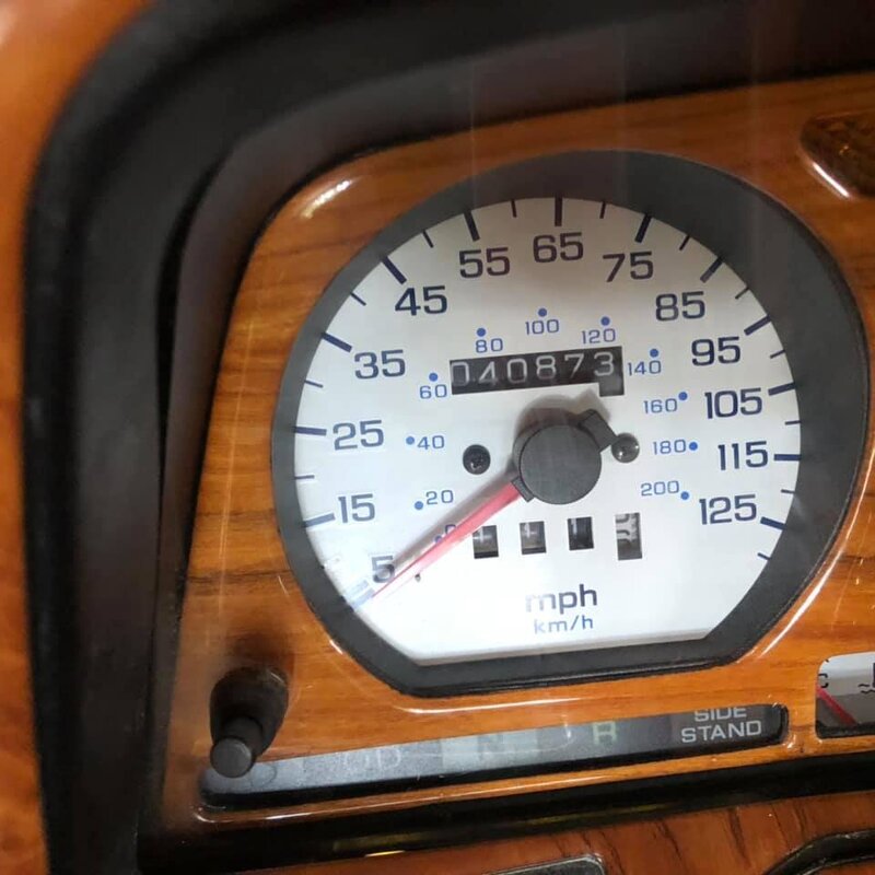

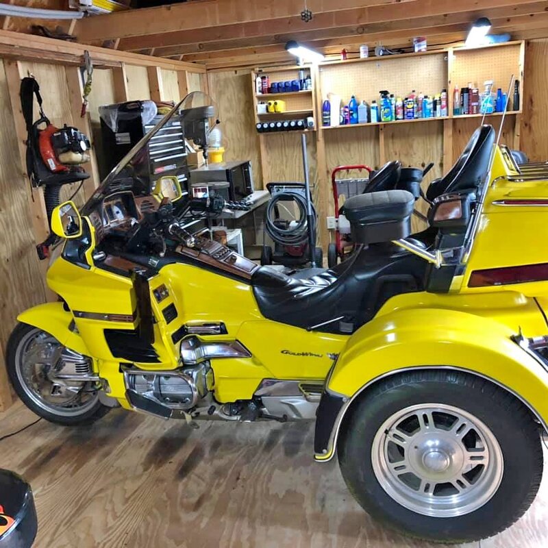

Got a few more pictures of the soon to be new to me trike...
Nice!
I see it has '98 style white faced speedo, etc as you said. Has pre '98 … more like even pre '96 style engine protection with the extended floor boards & good stout mounts. The wood grain is aftermarket, very nice too … aftermarket nice radio knobs. Pull that lone one, there's a key it's glued to ... to open the gas door, but you'll find the key is too short to turn the ignition, popular mod. It will open the right pouch though.
Looks to be a really nice paint job on it too. Someone "made it thier's" with a few additions & changes. All of the one's I had seen that yellow were 1800s, I love the color.
I see you have a Corbin Seat as well, some say they are too hard after pressing a finger into one I think, but they are shaped so well, the miles just melt. Pull the lever up & it raises the rider back rest a couple inches or so and it raises forwards in the process which really helps the back. The rider back rest can be just pulled up to remove or for co-rider ease of getting on or off unless the 1/4-20 cross bolt is in place under the seat? Yeah, I love my Corbin.

OK, that's better. :) For some reason I thought you said it was a 2000 SE or 25th Anniversary Edition. I was looking at pics and it just seemed not right for a 2000, but I see … it is a 1999, :) which had the white face speedo, etc. I was worried someone had an older model with newer speedo, etc, like a scam even … and it wasn't even me buying it. :laugh:
The engine guards have been changed to older ones ... likely to use the cruise boards. From '98 up, the loop was reduced to a simple bar, no loop and cruise board mounts were clamp on affairs for the most part, I would have made the change too.
