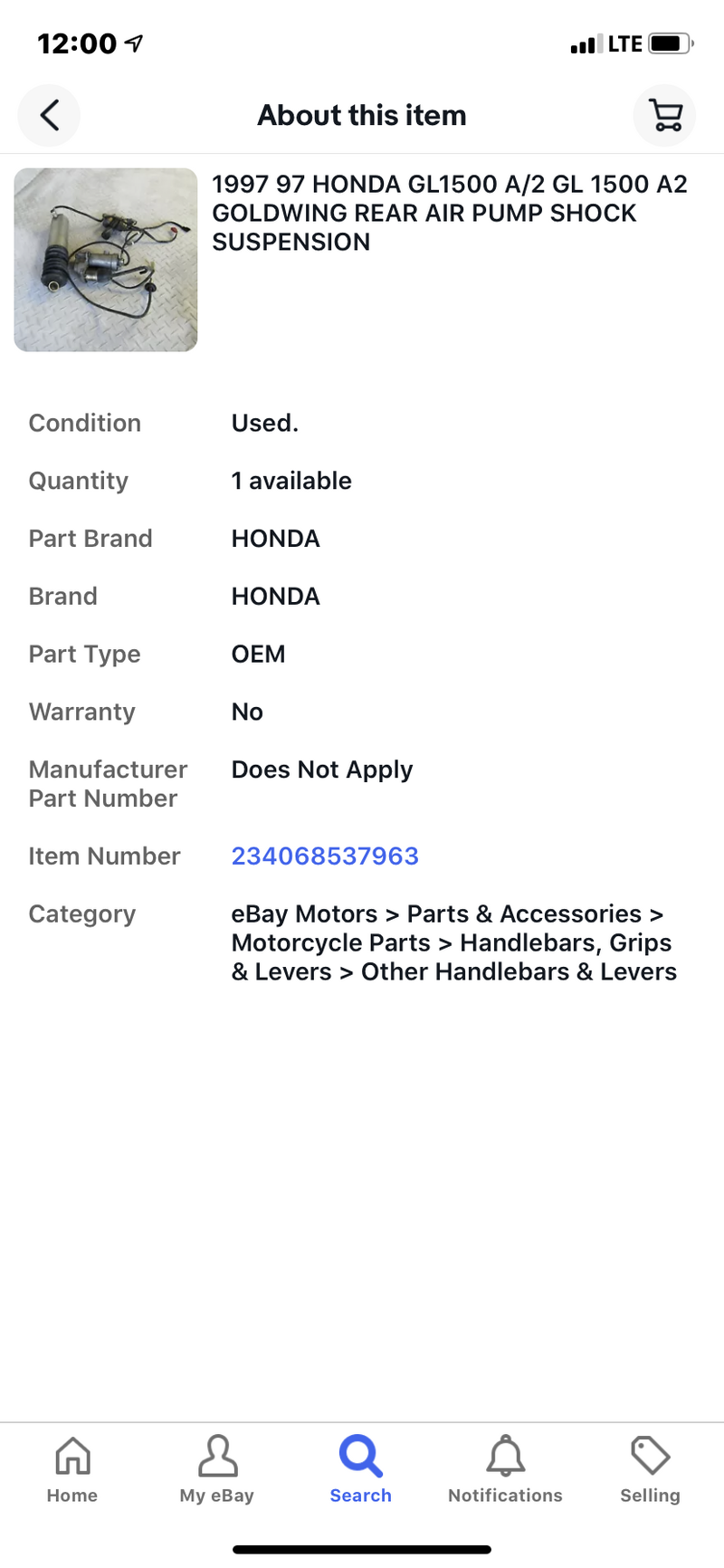

F50B8BFD-8BF4-4313-A26C-F1E5E819C03E.pngHello Brad. Check this unit out. I’ve purchased from this ebayer and he has great feedback. I would go this route before I tried to modify an after-market bag. Hope you get “On The Road Again” :wave4:
