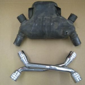

Anyone try making little louder than stock Pipes on 1500 trike?
Champion used Basani mufflers with their conversations. Take the crossover box out and put a pipe in place and they sound nice.
Mine is Champion conversion, I need to see if mine has a crossover pipe still......
Wow I have seen that under it. Wish i could hear one on here with that changed, may be better that drilling the mufflers
Looks like just take it off and do pipes in it's place, for much less money
Just watch the vid on that link, Looks like several bulk heads in that muffler , so just drilling it out may not work. Also I wonder if changing the back pressure will effect the running
