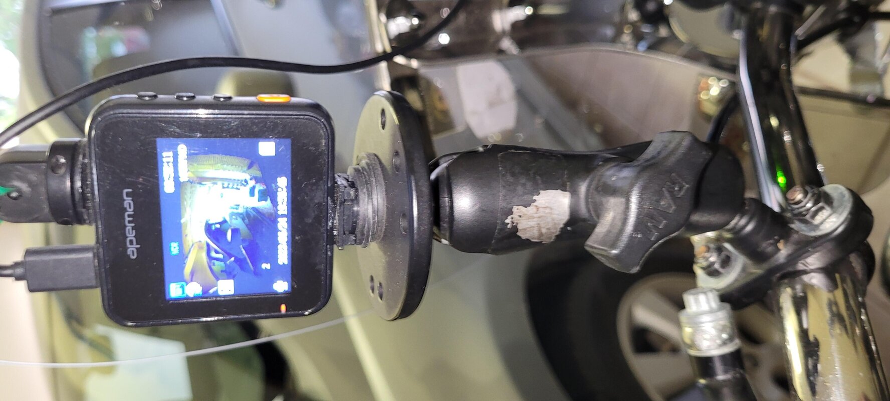

I do & have for years, now I have a Apeman C-420 1080P 170° wide angle (amazon) has on screen programing, loops, I use a 32 Minie SD card in it records 3-5 hrs. (long time) before it starts recording over the old.
Had to modify the mount, Camera slides into the mount & not secure (loose) vibration it would fall of also windshield sucking cup would not hold to windshield so, I glued a nut on the bottom & mounted it to a ram mount now it is secure have no problem with vibration with Video. I use Video pad video editor (free version) to edit, can make video's mosley I take snap shot from the video's picture goes to my photo gallery. If you get in front of me I gotcha. PS:: got to learn how to load Pic.
