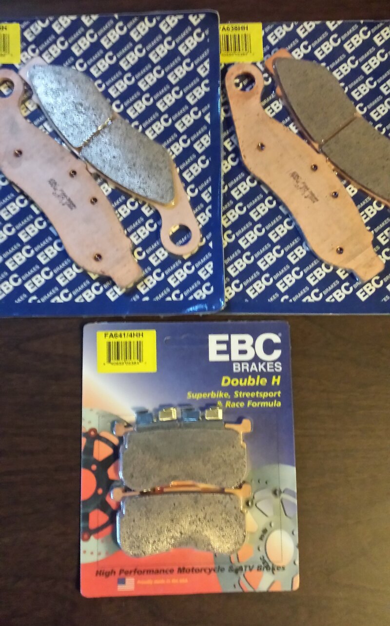

The EBC FA641/4HH rear pads should be 4 pads per card. I got a 2 pad card from Amazon "Powersports" vendor and EBC is sending me a replacement set. EBC said some 2 pad cards got out early in production.

Found a local shop that handles EBC. They did not have the 641HH in stock, but verified 4 to a set. Their pricing was almost as good as from Amazon, so I ordered a set, should be in tomorrow. We will see how it goes.
EBC sent me a complete new set of 4 rear pads and clips .... so now I have 6 rear pads and clips. :xzqxz:
