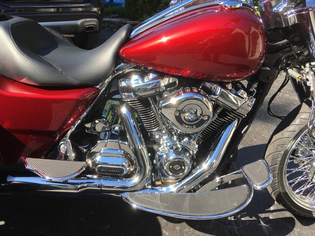

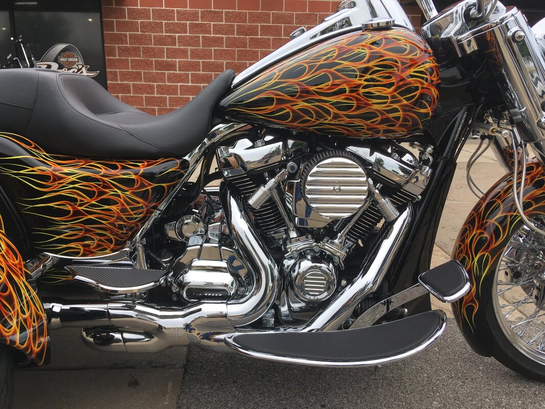

I have been thinking heat is the issue as well. But I was thinking about the rear calipers working extra duty to stop all of the trike's mass all the time. Never thought of pipe proximity to the master cylinder. Here is my setup:
Here is the stock system
They look really close to the same with respect to the forward pipe's relationship to the MC...
