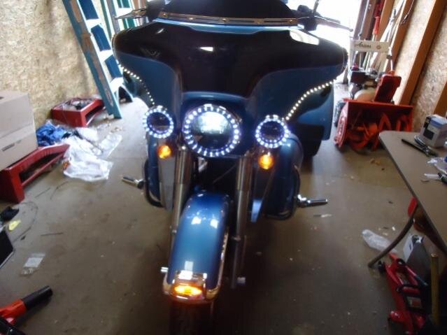

Really nice job. How about the front??

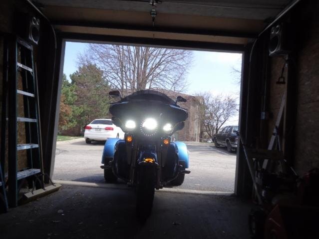

On the front I have The Kuryakyn (made by truck lite) LED Phase 7 Head light and passing lamps:
http://www.kuryakyn.com/Products/4205/Phase-7-Headlights-Passing-Lamps
Also have the Kuryakyn LED halo tim rings for the head light & passing lamps:
http://www.kuryakyn.com/Products/4120/LED-Halo-Trim-Rings
I have also got the independent-control-auxiliary-lamp-wire-harness-kit from Harley:
http://www.harley-davidson.com/store/independent-control-auxiliary-lamp-wire-harness-kit
This allows the passing lamps to stay on when the head light is on low or high beam. From the factory the passing lamps will only be on when the head light is on low beam. They automatically shut off when the head light is switched to high beam.
I have the electra-glo-fairing-edge-light-kit from Harley:
http://www.harley-davidson.com/store/electra-glo-fairing-edge-light-kit
And finally I have the Run-Turn Edge Accents from Kuryakyn that are running lights and turn signals:
http://www.kuryakyn.com/Products/4071/Run-Turn-Edge-Accents
See attached pic's. Sorry the Kuryakyn Run-Turn Edge Accents don't show up in the pic's but I don't have better pic's of them.
Oh and I almost forgot the front fender tip light is a 40 LED board not the factory bulb.
