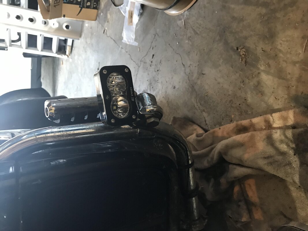

Sir - you beat me to it. I was going to tell him the same thing. To add, I might suggest you change the turn signal lights to the available LEDs - they also provide added light.
You should also look into the DK Customs driving lights that mount to the lower crash bar. Custom Dynamics also makes them if you prefer a chrome housing.
