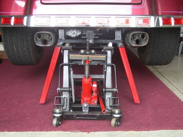

Tracy, the lift I have is different from Harrys in that it is long and low with a long jack handle. I think the cap is about 2000lbs. It has extensions that can be placed on top for a higher clearance vehicle (ATV). My son-in-law uses mine a lot on his Yamaha Rhino with 29.5 tires. I take the extensions back off and use it on the trike. Look in the Craftsman tool catalog and they have a picture of this one and the red one like Harry has. Regardless of what kind you get, Harrys picture made me remember, USE JACK STANDS! If you can't find one, let me know and I'll take a pic of mine and post it...

Harry and Jim thanks for all the info. Harry your pictures are great and Jim I know what jack you are talking about. When you use your yellow jack are you using it from behind like Harry or from the side?

I'm hoping, however, that Harry sees a need to improve on his design and thus because I am such a nice fellow, and regularly quotes him on another board, sends me his old design after he builds his new one. ;):cool: The extra clearance would allow me to better fit under the bike. Now where did I put that Richard Simons tape?

Wheels, just cause you are such a pain and you need all the help you can get, next rainstorm I will go out in the cold shop, strain myself and weld you up one. You got a reciever for a hitch? And I will let you drill you own hole for the safety pin. But the Jack is on you when we finally meet.:)

I made a rear bar that slips into the trailer hitch, and hold the frame while the ATV lift lifts the rear of the bike
2 Questions
1) you "stand" fits into the Trailer hitch.... and the entire weight of the bike is on the hitch... Is the Hitch able to handle that much weight?:confused:
2) Hoe in the HECK did you mount your trailer plug to the chassis, I wanted that type of plug but I couldn't figure out how to mount it.:confused:
