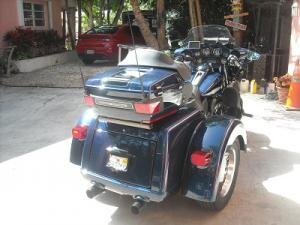

Heres a picture of my 2013. The plate holder is a standard MC plate holder. It was on my 02 and 07 now my 13.

You need to see how the tag frame is mounted on a TG, bolts at the top, and sits into a support lip at the bottom. Most tag frames only have the top mounts.
By the way that lip on the bottom bracket is adjustable. I took it completely off mine and just run with the top bolts to hold the plate and frame in. If you take the whole thing off you will see that the bottom bracket is slotted. Either move it to fit or if it is in the way take it off. I finally figured out what you were saying. More than likely it will be in the way.
