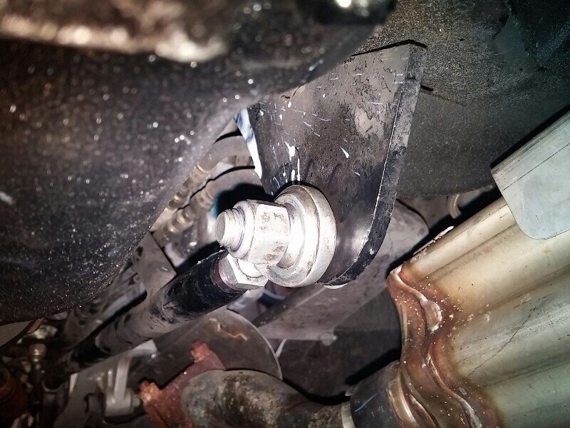

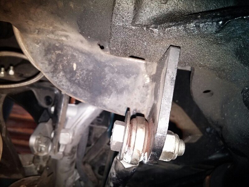

However I noticed something different on the left side that didn't match the right side or the service manual found on here.
The RIGHT heim is installed on the inside of the axle bracket towards the center (or left side). And the SINGLE washer was on the inside against the nut/heim. (Washer temporarily moved while fine tuning level).
The LEFT heim is installed towards the left tire away from the center line on the opposite side of the axle bracket. The SINGLE washer is between the bolt head and the axle bracket.
Which is correct?
I believe the service manual has installed towards the center using TWO washers.
Which is correct?

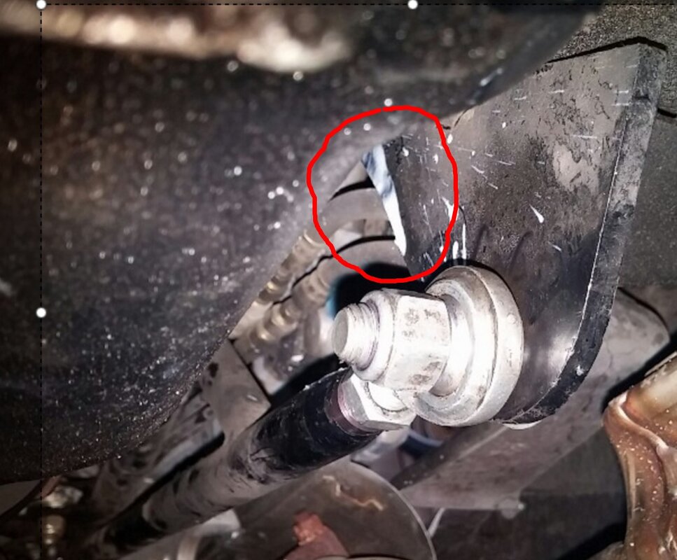

It looks like the bracket in the top picture is broken. Look at it again close and see if its broken. If so you have a problem. Let me know. Hope Im wrong...
Not the gap, the clean metal break on the rear of the top bracket photo. Appears to be a fresh break, bare metal no rust. Again, I could be seeing something that isnt there, but thats what it looks like to me from looking at the picture.
I'm pretty sure that's white lithium grease with the light hitti,g just right.
