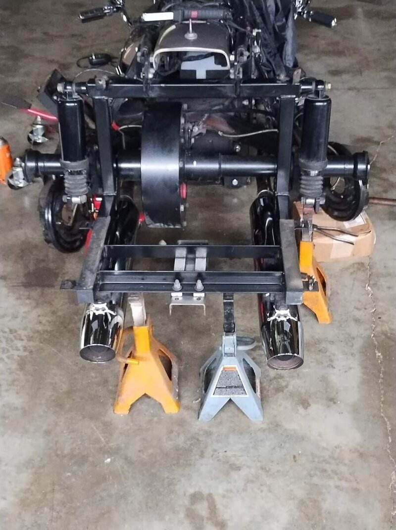

Hello all,
I am looking for a drain on the this 99 Harley FLT Ultra Lehman differental that I purchased this year. It had sat for a long time so it required many updates, repairs and replacements to bring back to road worthy. In doing all the work i have been looking for a drain or lube location on the differental. Where and how do you change to oil if there is any? I have the Renegade Lehman installation manual and see noting in it about gear oil. If you know th e secret please share with me.
Photo sample not my trike.
Hey! Those old Lehman trikes usually don’t have a drain plug. You’ll need to pull the differential cover to drain the oil, then refill through the top plug. Bit of a hassle, but that’s the setup. Good luck.
There is no drain on the differentials for the Harleys or other with chain or belt drive. They have a grease fitting that you put about six pumps in ever 10,000 miles.
