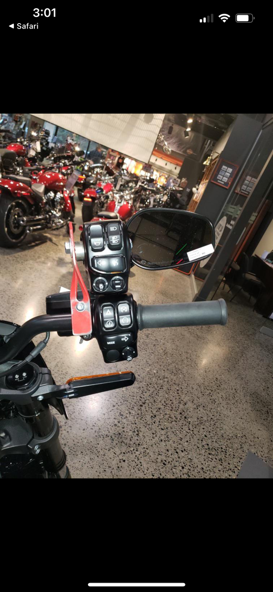

Another picture I had seen for a jury rigged Harley right hand control was this. Obviously it could be dressed up a bit. Looked like they sawed off the end of an old set of handlebars and put a bolt through it to a strap connected to the bolt on the other switch pod control. Not very pretty but guess it works.
