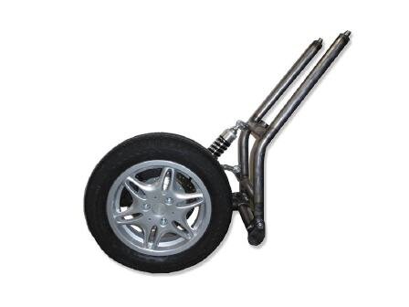

Found this online
this one looks like it is a car wheel but has both sides of the leading link
I wish I could see it better and both sides
