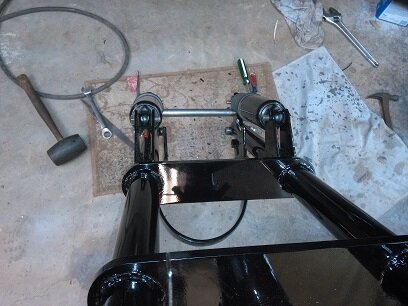

Ok some pictures but please remember im not a painter , welder or fabracator.Just an old fart trying to build a ride .lol I still have to paint up fender and dash and then trace all the wires out and plumb out the front brakes. Just maybe have it ready for bike week.
