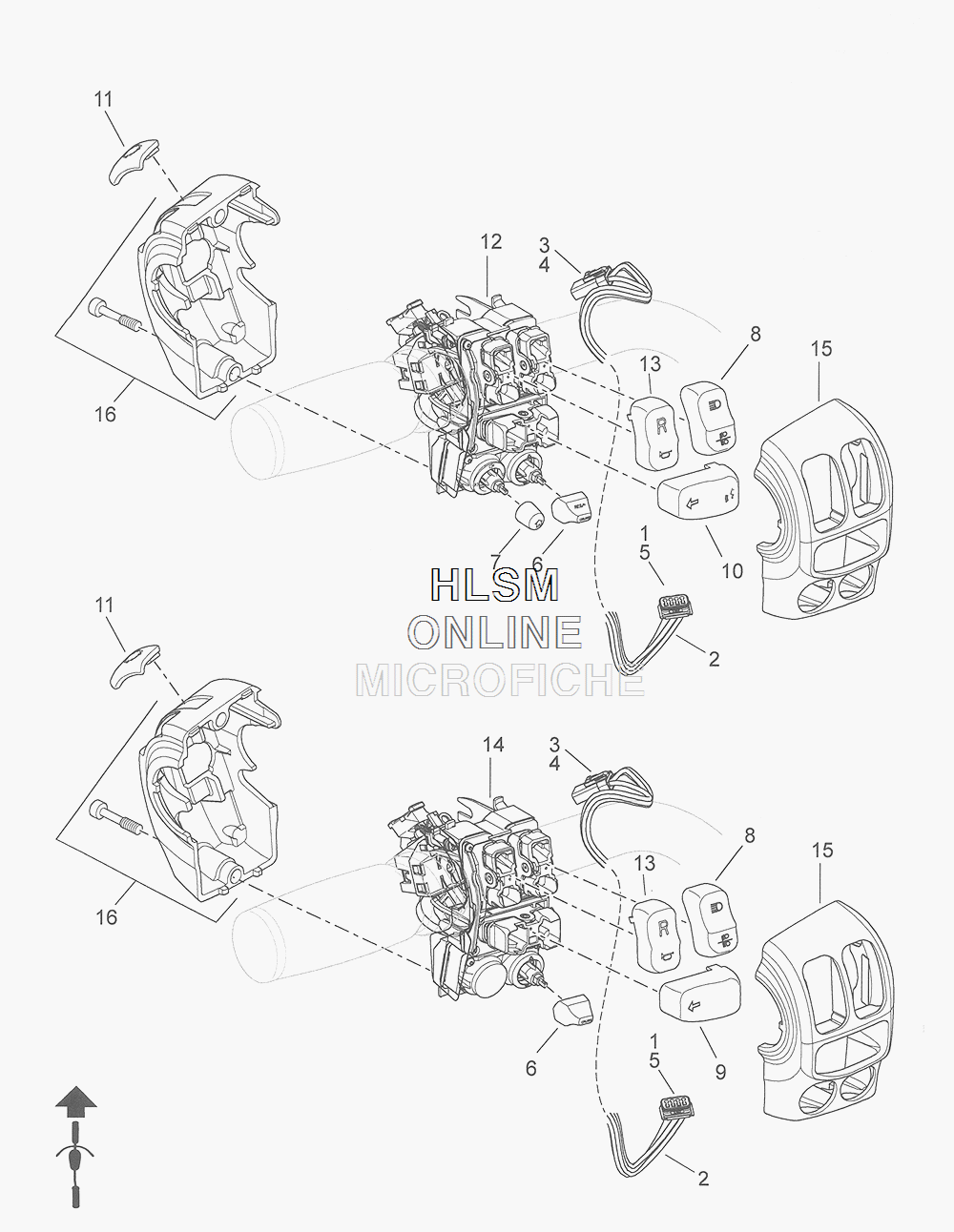

No such moel 2013 Freewheeler, 2015 was first production year, see below for the trigger switch to view your mileage, #11, LS handlebar cluster

is the switch a common problem
No, however HD has upgraded this switch
Have you pressure washed your trike, or ridden in hard rain recently?
The switches are supposed to be weatherproof, tho I had a failure on my 15 model, replaced under warranty with a newer version switch
thanks.. i dont use a pressure washer but i do wash it with a hose
i quess i will be buying a new switch ..Is it a easy swap out??

Brian, before you go change out switches and if you think it’s water that caused the problem spray the switch with some lubricant contact cleaner..Not WD 40..

Bob, that does not work the switches are microprocessors, it does work somewhat on the clutch switch nipple tho
AS far as I know HD is on their 3rd generation of these switch paks, my 15 model had the A and B models both installed before I traded it

Jack I always- Use the Principle of Parsimony…IE ; Go to the simplest solution first….And if it doesn’t work you can always use the contact cleaner for something else down the road..

well i replaced the switch and that did the trick..
I called the motor company and was told just because they change a part number dosen't mean the part had a problem..
they said they do it all the time because they change manufactures
Yea….And they changed manufacturer for 3 reasons..1} There was a problem with the first manufacturer parts- 2} The new manufacturer undercut the first manufacturers price on the parts or 3} A combination of 1 and 2….. …
