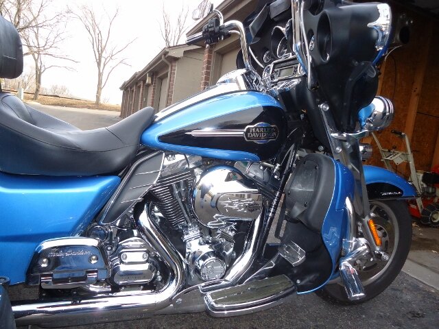

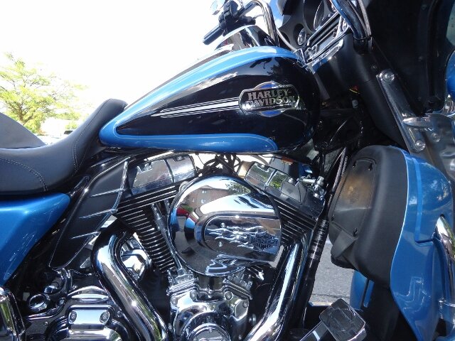

Well I finally got to playing around in my garage and my son and I made a tank lift for his 13 Road Glide and installed it. Well I kind of liked the way it
looked so we did the same on my Tri Glide. Left pic is before the lift and right pic is after.

Amazing how such a "small" change can make a big difference.
Have you been out riding with it yet? Lots of guys notice less buffeting because more air is going under the tank and across the engine, instead of over the tank and hitting them in the chest.
Do you think it helps with the heat and makes the ride cooler?
We have done quite a bit of testing on this. It reduces the cylinder head temps (taken with an IR gun) by 10-15 degrees after 30 or more minutes of interstate riding.
We have done no testing on if it makes the ride feel cooler for the rider or passenger.
