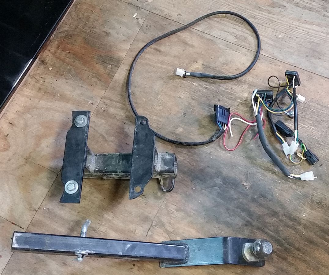

Photo of receiver, hitch and electrical. The electrical is made up on HD compatible connectors, a CanBUS module, an isolator, and connection to the trailer.

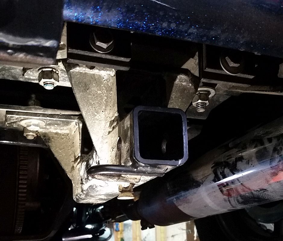

Receiver installed...bolted to the two cross-members below the trunk.

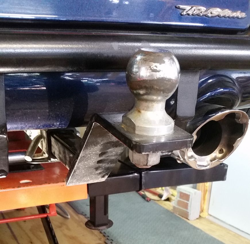

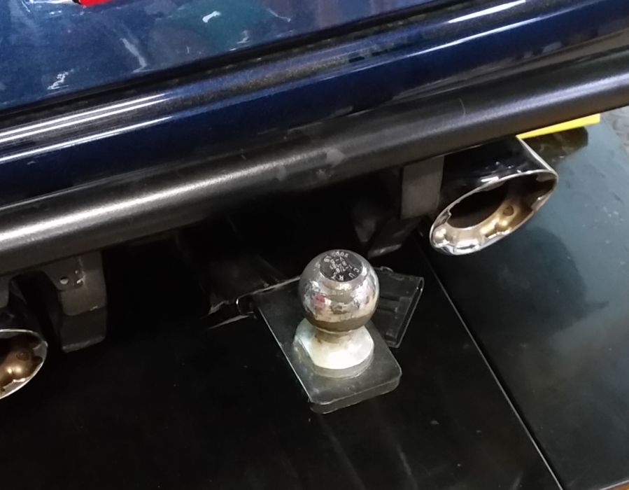

Hitch installed. Held in by a standard pin and clip. There is also a set-screw to keep it from rattling in the receiver.

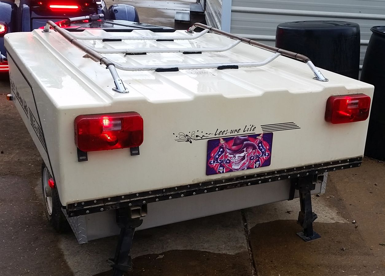

Hooked up and working with a trailer.

The hitch is a one-off, built before they were readily available in the aftermarket.
I have my wiring harness set up to unplug within minutes and i can have the hitch off in about ten minutes if i need to take it in for warranty work.
