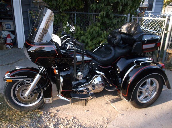

Which is precisely why I converted my old tour glide.
one big advantage is an over-all 9 degree rake and it responds and out steers the tri-glide hands down. I don't even use a steering damper.
I recently installed a new set of heavy duty progressive front fork springs and it really did upgrade the ride.
I like the handling I get with the champion straight axle kit. It's a little rough in town but smooth's right out on the highway wich is what I built it for.
