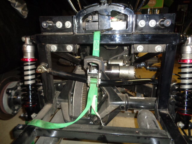

No problem I plan on removing the trunk it is easy to do. I wanted you to see how I jack it up in the back with the small Trolley Jack. it takes a little to do but better than working on the floor. This way I'm not spending money on a jack for trikes I use the lift jack for numerous things. :good: travel safe Fred

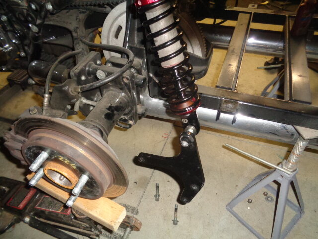

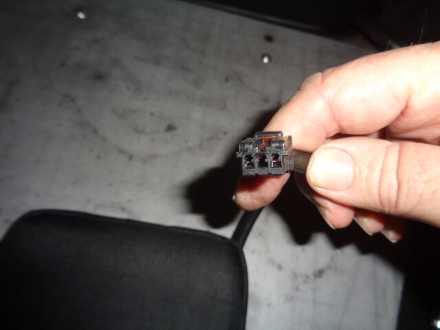

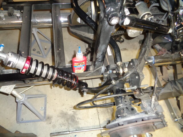

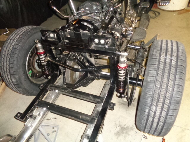

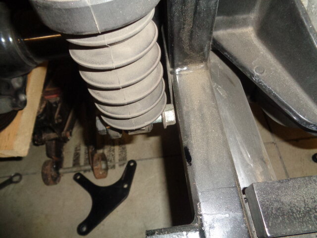

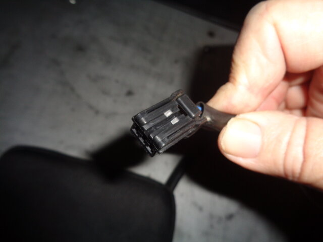

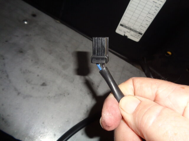

Today the shocks were delivered I couldn't take it since the old Shiney was already up in the air. Disconnected all wiring and unbolted the rear portion. What bothered me most the speakers are hard wired but I suppose there is a reason for that I unbolted the boxes and laid them on the ECM. Next remove the six bolts that hold the trunk on not to forget the ground bolt in the upper left corner, remove the strap then remove the stud. Last year I completely cleaned 9 years of crud off the frame and touched up spots where the powder coat failed, all in all it still looked fairly good. I even removed the two allen head bolts on the front portion of the body. Shock install tomorrow evening I hope. Fred

Some Gorilla put the shocks on my Trike! I just attempted to remove one of the shocks and I can't budge it with a 3/4" wrench it is getting late so Air Tools tomorrow night. Should be a done deal then, finish cleaning the frame and change to comfort lift Wa-La Done.... Fred

Spray them down with with liquid Wrench or the equivalent and let them marinade over night....
They are installed with red lock tite.
If they were installed by Harley they use dry wax type [tan color ] loctite It makes a chemical bond by the friction from tightening the bolt....
Just to add most factories stopped using liquid loctites ..Cause it takes longer to apply$$ , Drips all over and will damage any paint or plastic it drips on..
possibly old Shiney was lifted years ago these are really tight I only tried a standard 3/4" wrench last night I will get the serious tools out tonight. Thanks for the response.:good: ride safe Fred
I remember those top bolts were a bear to remove. With the residue of the factory lock tight still in the RR , the bolt reinstall was no picnic with the new shocks.
