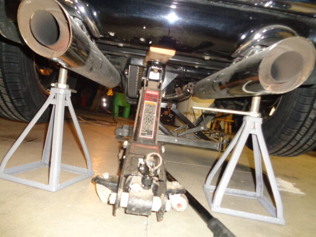

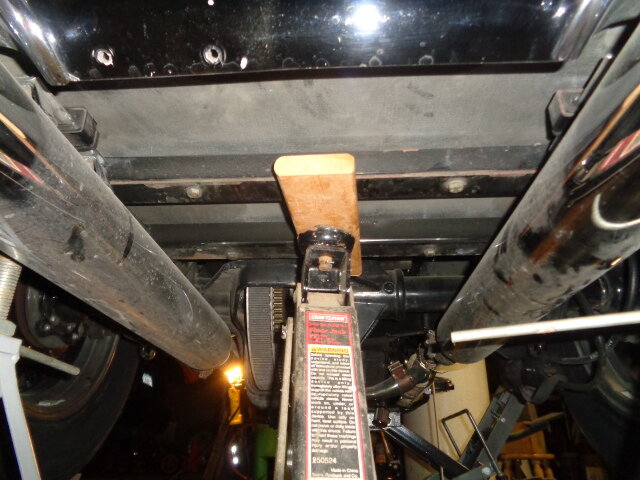

Well you know an air wrench can do wonderful things everything worked like a charm until I ... Started to install top bolt on the shocks, figured it out though. The reason these triglides ride so rough is not the shocks fault, it is the design of the swingarm it is so short what one side does the other has no choice I say that when installing the top bolts. I have a picture with a green ratchet strap in the middle picking up the swingarm and both sides aligned at the same time. So there is very little room for error on the shocks to stop any sort of bumps or ruts or anything for that matter.
Now old shiney was already lifted I have those for someone who has not lifted ther Tri or freewheeler yet let me know.
Another thing I needed to unbolt the top of the shock and remove the lower bolts on the shock mount to get the bolt out of the bottom of the shock no clearance between frame and bolt nice.
DSC01552.JPG So the rest of the job was just turning wrenches and cleaning the frame before we put the body back on. Just as a note the alignment job I did last winter worked out really well the drive belt is in great shape running in the middle of the front drive pulley I just smiled when I saw that.
I will add if anyone needs a pair slightly used air shocks let me know I will give them a real good deal. I for myself never work on the trike with the body on if it needs to come off. it is so nice to see what you are doing and easy not on your back on the floor. :good:Wrench Safely Fred

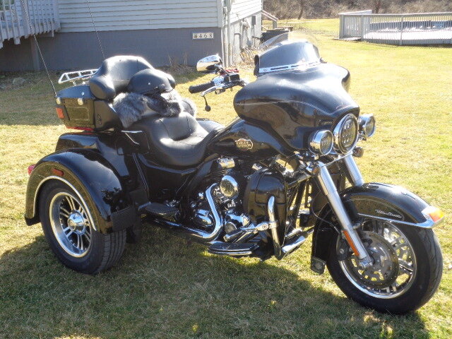

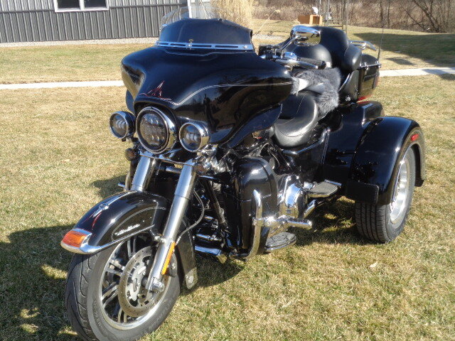

Out for the first time Evaluations...
First the Pro Action shocks are a huge improvement hands down. For as poorly as it rode before seems like a different machine now. I rode across a road not far from home that was a second gear at best third gear ride. Well now I can comfortably travel in 4th to 5th gear what a difference worth every penny invested. You will not eliminate the craters or holes you can get lost in but for the most part very very satisfied with the ride now.
Next was the tire change I change from 65 series to 70 series on the tires to gain a little more road speed, I believe it is a good change I lowered the rpm in 6th 200 rpm's now a 60 I'm at 2400 to 2450 Not a 2600+ motor seems to respond well no lugging and No screaming For Interstat e travel it will be ideal or the occasional childish flash backs we all get. In my opinion a great change. I started out with old Shiney with 32 tooth front pulley, two years ago swapped it for a thirty tooth great improvement in gearing very pleased with the new found bottom end torque. As time went on I watch my riding habits change with using 6th gear that I rarely used before and found that it seemed to be in the middle of what I wanted the RPM's to be. Very satisfied with the new tire size.
Next was really nice thing for comfort the extended shift lever really nice may take a little to get used to but I will make the transition.
As for the sheep skin cover on the seat time will tell seemed comfortable on the maiden journey hotter days this summer will tell the tale on it.
Ride safe it was so beautiful to get out today Thank God we live in America literally Thank God we live in a America. nowhere else on earth comes close as living here in United States of America. :good: travel safe Fred

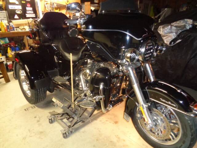

And now the 2020 edition of Old Shiney better than before not as good as it's going to be. (now the front forks need a few new parts coming soon)DSC01571.JPGDSC01572.JPGDSC01573.JPG.
P.S. I just returned again took the Bride for a ride she loved the new shocks although it is higher to get on with the 205X70X15R tires they seem to really work great quiet and handle well in the turns with two up. May drop air to 20 PSI I'm a 22 now. Fred
