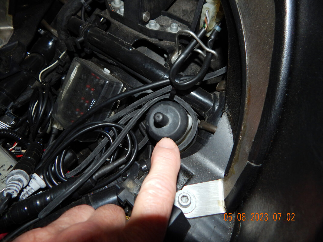

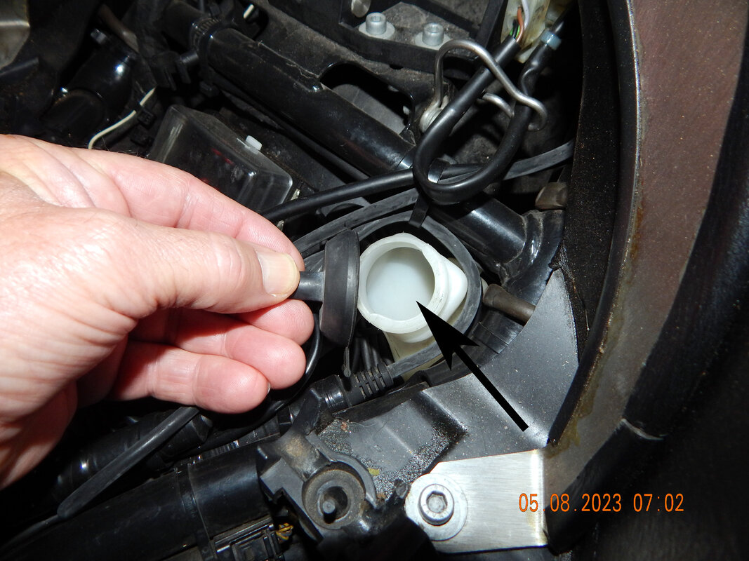

New here tried to do a search, found nothing. I have a new to me 2008 bmw k1200lt hannigan and I am unable to find where to check the coolant level. The owner manual says behind left bag. With the trike kit on there is no bag .do I have to remove fender? Any help would be appreciated. Thanks in advance feeling not so smart right now.
Check coolant level.
About the only easy viable way to check the coolant level is to lift the front seat up, open up the coolant fill cap and look into the tank with a flashlight.
