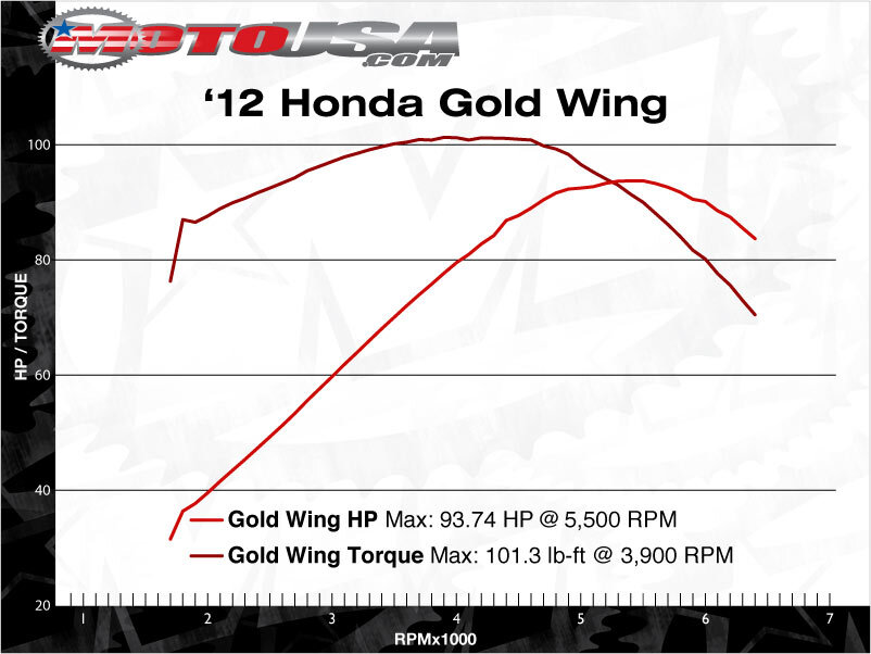

Yes. One with 118 horsepower.
Buy a Goldwing. You'll never even know that pipes actually give off heat. Or... keep pumping thousands into your Harley.:Dorag:
