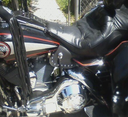

I picked up this under seat heat deflector off E-bay From HARLEY HEAT SHEILDS for $45.00.
Nice thick leather well made and fits my trike to a tee.ThumbUp
I sent him info on make, model, and year. Was hand made and delivered in a reasonable time also.
The owners name is Tim Sloniger.
Installed my Captain Itch leather heat shield today. Although it wasn't a really hot day here, I rode around for a couple of hours and felt no heat on my right leg. When I got home I felt the leather and the right side was quite hot, so it kept all that heat off me. One small step in reducing heat on your right leg, and it looks pretty cool too.
