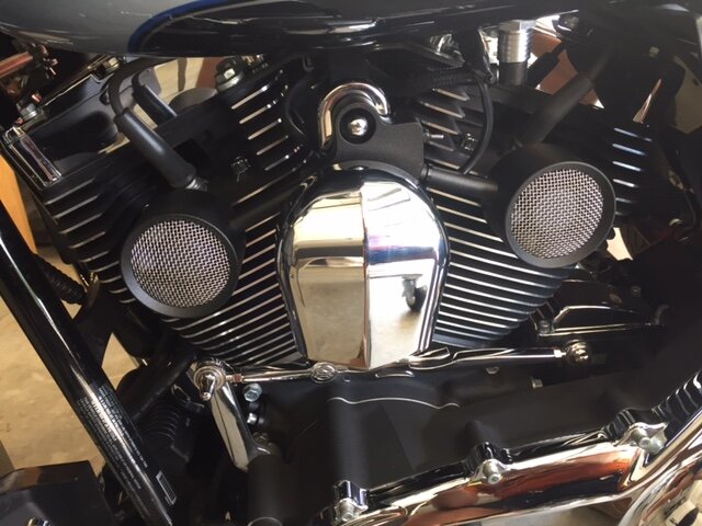

I added Fans, it helps on the stop and go with heavy traffic. Put my foot up on the peg and the air blows under my leg. Works good for me.

IMO, the Love Jugs is the best money spent
Instead of blowing HOT air down on top of the transmission AND IMO blocking the oncoming air flow like the HD fan does ( Why does it cost so much from HD) ever wonder about that?
You can contact Randy (Papa Zook) here for more info on the Love Juggs
I leave mine on whenever I am riding, it has made about a 50 degree drop in engine temperature
