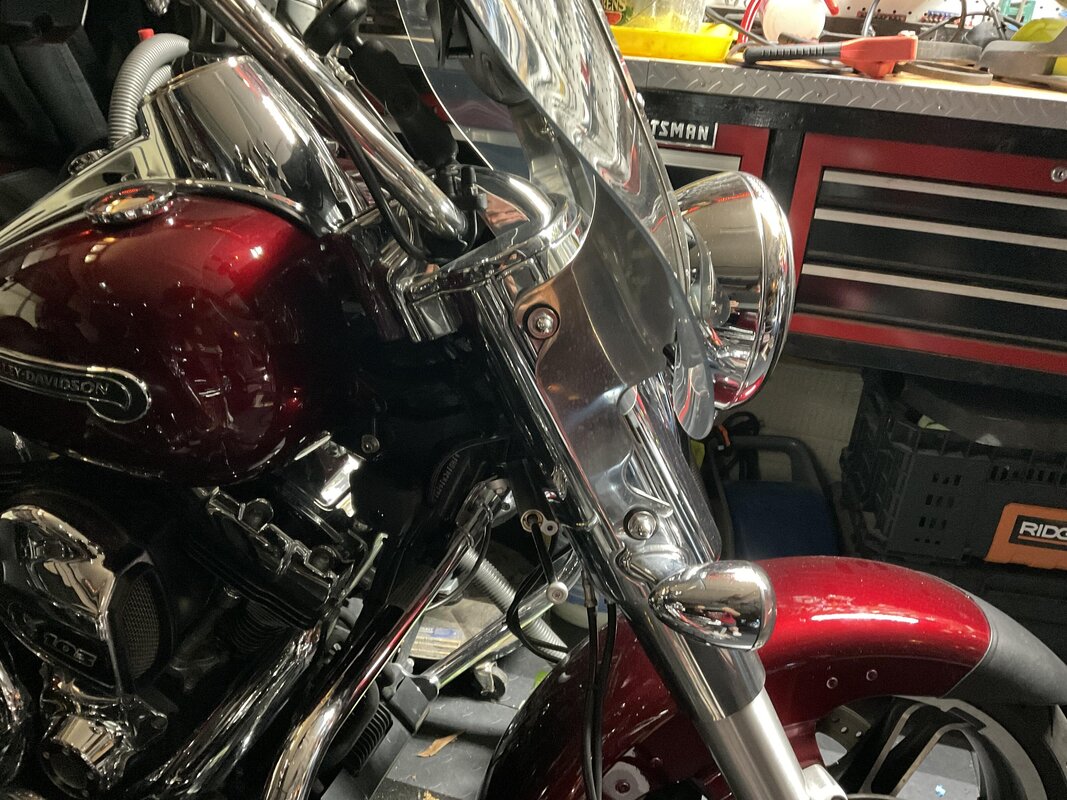

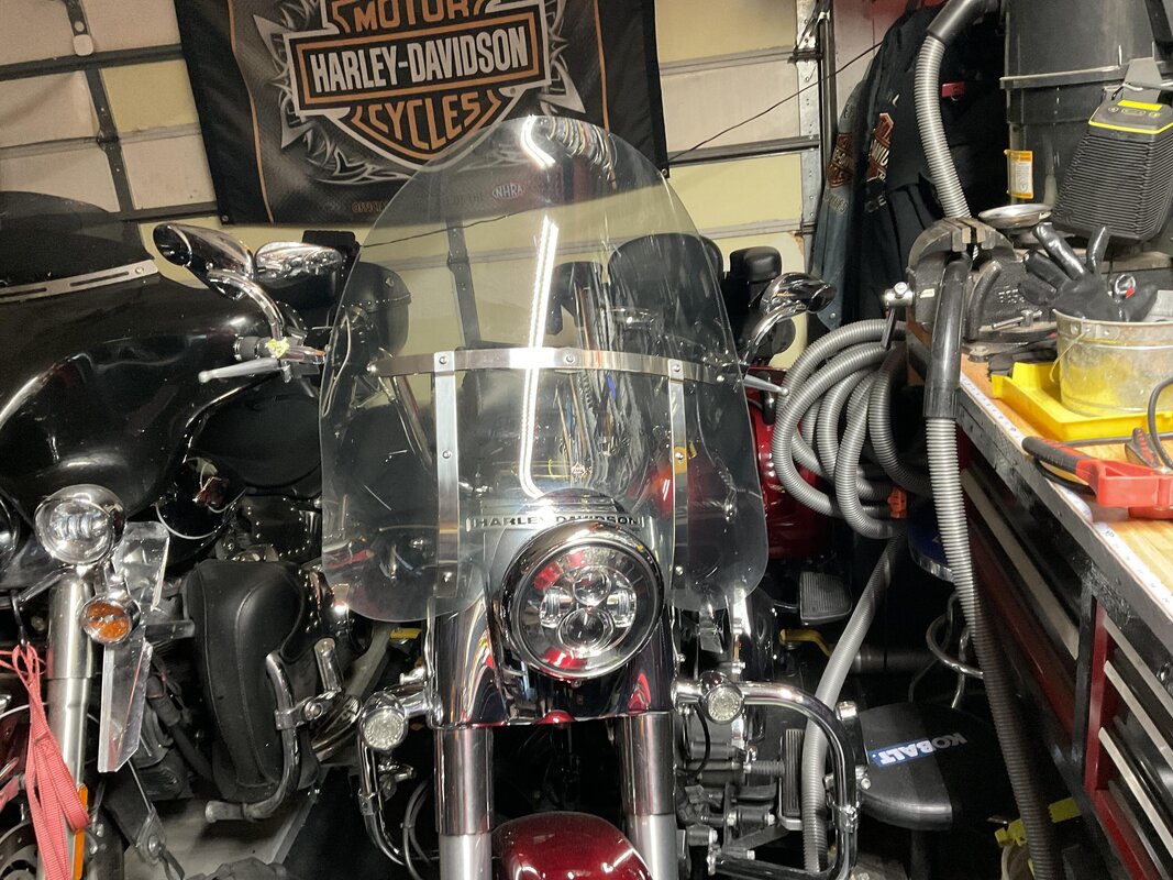

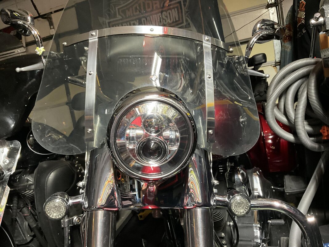

However the pictures below are of a 21 inch Klockwerks windshield that was on/purchased for a 2019 Heritage that’s now on my 2016 Freewheeler.
The mounting brackets for at least a 2019 Heritage are the same spacing as the 2016 Freewheeler however they have different mounting points so they are not interchangeable.
I wouldn’t think the years would make a difference.
My Freewheeler came with an OEM windshield on it so all I had to do was swap the shields using the same brackets.
I’m not sure if the Road King brackets are the same as the Freewheeler, you might have to ask the Dealer.
But even if you find a softail windshield you’re still going to have to get a set of Road King/Freewheeler brackets.
