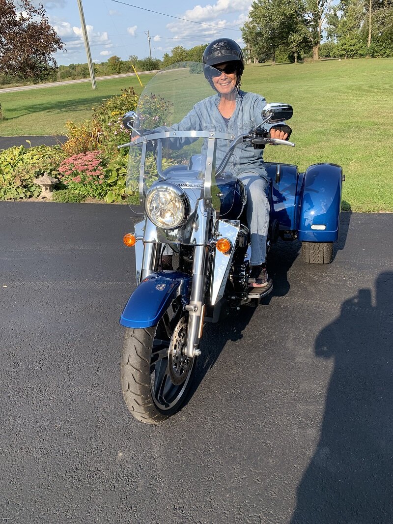

I bought a Harley windshield for DW's 2022 Freewheeler before she even took it onto the road. I should have known it wouldn't be adequate for her when on the ride home from the dealer delivery, her magnetic clip-on sunglasses blew off. She stopped and found them undamaged but she had to buy new prescription glasses for the trike.
Her previous trike FLHTCUI / DFT conversion had a fairing and she never complained about the airflow over 10+ years riding.
So.... my question is: has anybody replaced their windshield with a fairing and how did the airflow compare?

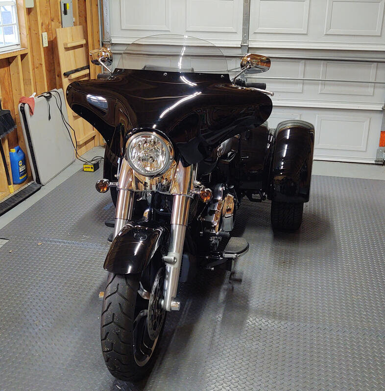

Well, that's a really subjective question. Some riders consider ANY felt wind to be buffeting. I run a Batwing Fairing from Memphis Shades and have 15,000 miles on my '21 Free and what breezes I do feel have never been objectionable. My glasses don't shake, there's no wind on my torso, the only place I get wet in the rain is my ankles and a bit of spray on my goggles, unless I have to stop of course. :) I have no other wind deflection devices on the trike and have so far not encountered any heat issues with my M8 motor. Don't know if that helps or not.
That is good info. Buffeting is when your glasses and head shakes or your helmet shield flips up. When I first got my flrt I had just the hd windshield and on long rides the buffeting was so bad I would get headaches and blurred vision.
Your bike looks great with that fairing.
