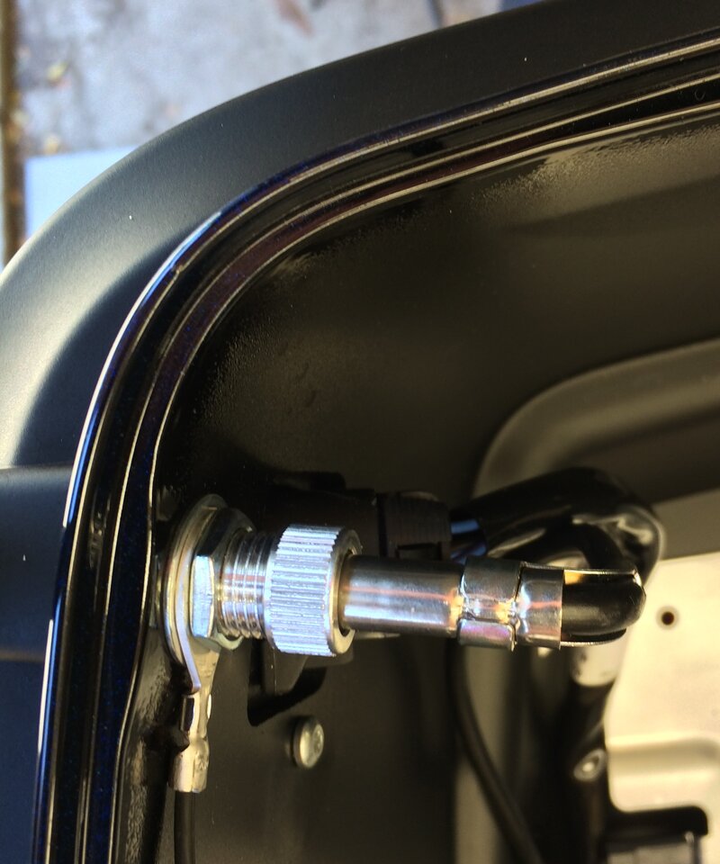

Help with I.D. of Coax leads
CB connection looks okay to me. Wire attaches to the center of the antenna.

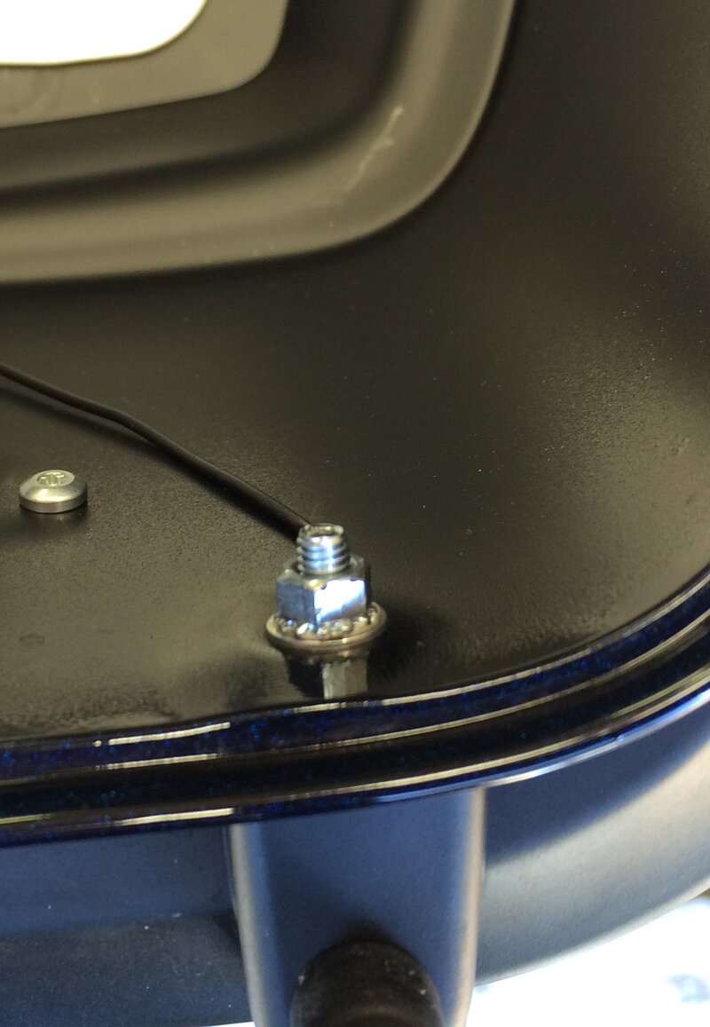

The right hand pic looks like just a ground wire. As far as my '10 TG goes, looking from back, the AM/FM is on left and CB is on right. If you look real close around bottom of antenna's, near base, it actually says what each one is. Bring a magnifying glass.
AM/FM is on the left and the CB is on the Right. I checked both antennas and they are on the correct stud. The ground for the CB is 16 or 18 gauge and snap into a notched area on the metal plate. Today I made a ground strap from the plate to the frame. Hopefully this will help. My CB shop told me there is not a whole lot that can be done to improve on the CB attached to a motorcycle.
