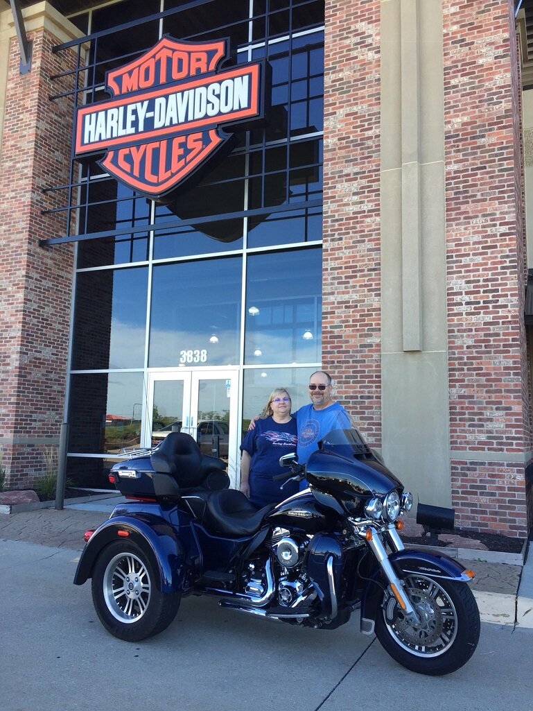

I'll post some pics later just because people like them. :)
It was a busy weekend! Changed out the bars to Khrome Werks 2+2 narrow sweepers as well as the heated grips. I also removed the V&H Dresser Duals and put stock head pipes with the catalytic converter back on. I'm running S&S MK45 slip-ons.
