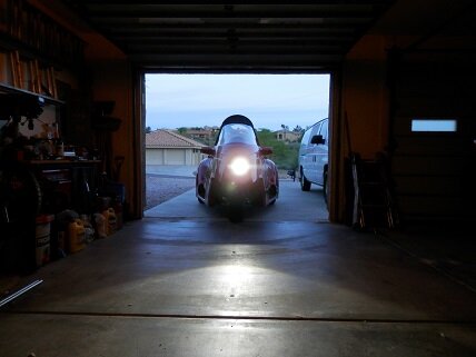

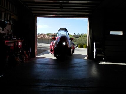

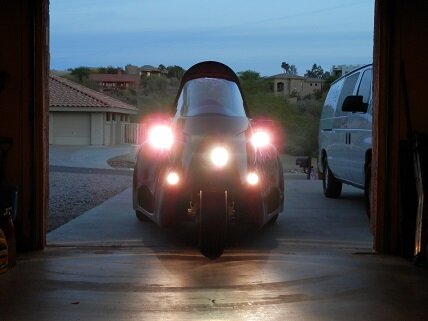

Here's the difference in the lights. The first picture is with the OEM halogen light. The second is with the HID's I installed. The third is with everything I have up front on. I do light up the road. None of the pictures have the high beam on as with that on, the HID washed everything else out. Rick
